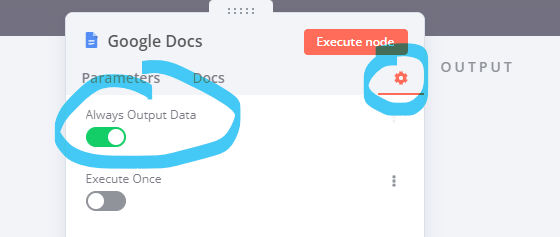

Hi @terryble66, from taking a look at your workflow your data is essentially duplicated on the Notion meeting page node. This node connects to two different branches. This is fine in itself, but you then have two separate items (one from each branch) going into your Set Example Data node. Meaning everything from that node onwards runs twice.
So, you would typically want to avoid such a construct. Perhaps you can remove the direct connection between Notion meeting page and Set Example Data? Then make sure your workflow doesn’t stop on your Notion_blocks node by enabling the Always Output Data setting of the node:
And lastly, connect the False output of your IF1 node with your Set Example Data node to make sure the flow continues even if your IF1 condition isn’t met.
