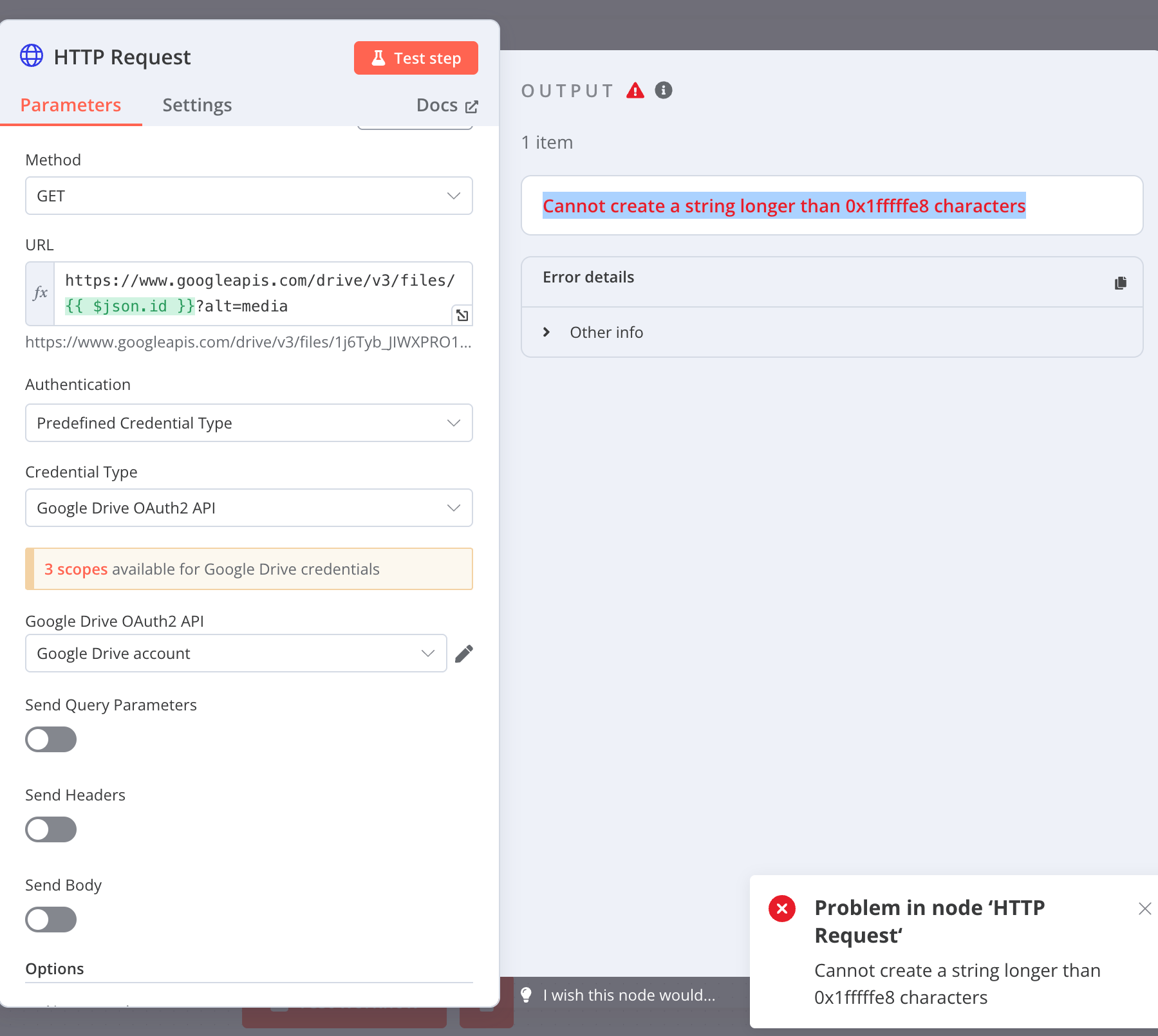

The problem im having is this one:
Also i tried instead of an http module , i tried with a drive module but still does not work.
The video im trying to upload its 654MB and about 6 minutes , i dont know which is the maximum capacity to this.
