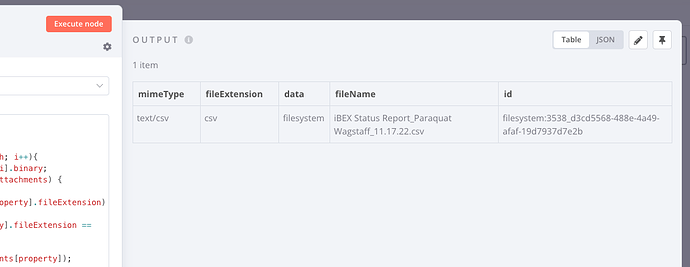

I’m able to get the message I want from the correct label I want. The problem is, there may be multiple attachments in the email, including signatures that I don’t need/want. I specifically need to extract the CSV attachment from the email and need to process it, but I’m unable to download just the CSV. When I go to try and filter just the CSV binary file, I’m getting rid of the binary data itself apparently.

I’ve tried this way too. This way what I’m running into is I now have 2 CSV attachments I need to pull. My code finds the Binary property. nameI need, but I then run into an issue on the spreadsheet node. If I manually put the property name I get the data for that particular CSV, but I’m unsure of how to get the next.
If I do expression, I can only figure out how to get the data from attchment_0. I can manually put attachment_1 to confirm that there is data that can be pulled from the Binary file.
Hi @Philip_Wiggins, perhaps you want to check out the example workflow at Split Out Binary Data | n8n workflow template? It converts one item with attachment_0, attachment_1 etc. into multiple items with just data which usually makes looping through them a lot easier.
