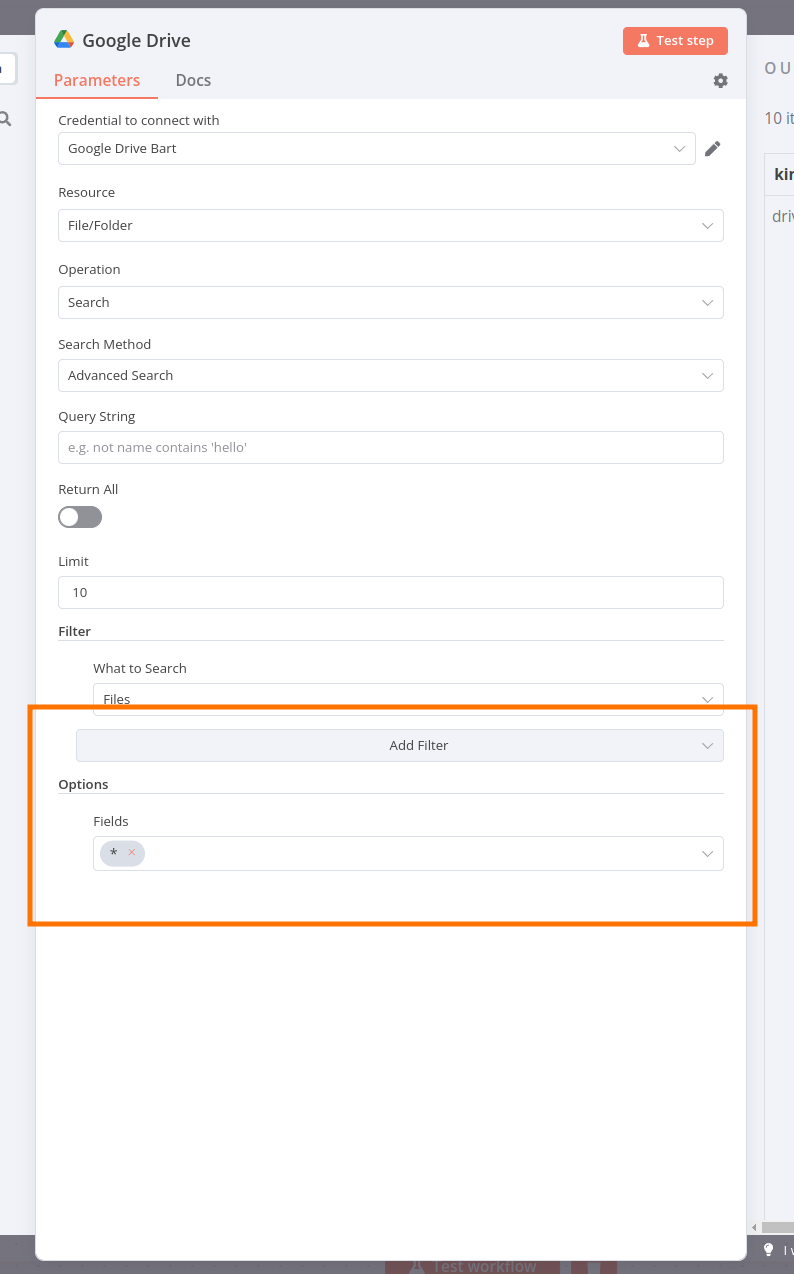

I took a look and couldn’t find a way to sort the results in the Google Drive note itself. However, if you set the options to export all the available fields, you’ll get access to the ‘modifiedTime’ property:

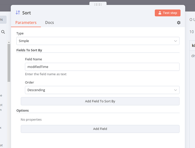

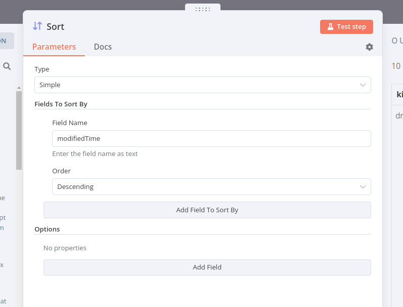

If you then use a ‘Sort’ node and set it to sort by modifiedTime (just the text, not an expression!) and set it to descending, you’ll get the most recently changed files at the top of the results:
