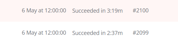

After a while my workflow started to trigger twice each time instead of once on a trigger.
This was either due to an increase in process time after the trigger or as a result of adding a cron expression.
I removed the cron expression and re-created the workflow, but the situation remains the same. To me, this is a rather complicated issue that is unclear how to resolve.

Hello,
So, I can assume it has to do with the processing time of the process. The first query in openai is text generation. The second one is generating an image.
This process takes about 2, 2.5 minutes total until it gets to the database update.
But the same error never happens during a test run or if I run this process on a trigger from telegram.
Does it trigger the second time after a minute or something like that?
Or directly 2 at the same time?
It was both.

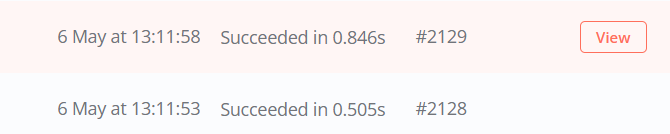

Or like this…
Unbenannt2
that is basically the same time yes.
Can you disable the flow and see if you then have only 1 trigger?
I occationally have this issue. I think it’s related to a bug while saving the workflow, that will cause this duplication.
The solution (for me) is to restart the container.
