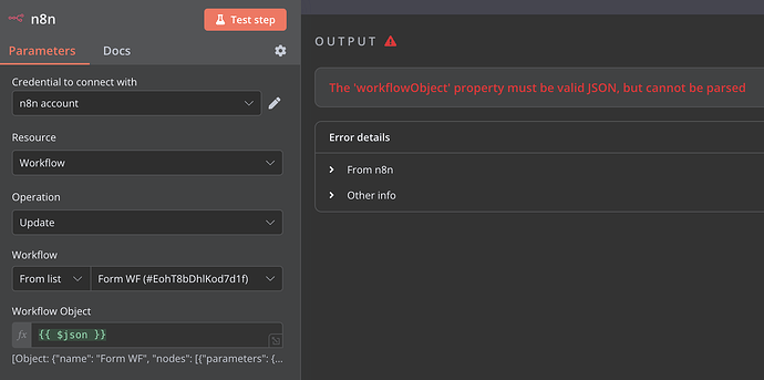

Workflow with Asana node that will update the Form WF
You will need to create the n8n API key in the n8n settings and save it as a credential. Plus execute the n8n node with the workflow ID of the Form Workflow
btw @Jon , do you know why the n8n node through an error with the JSON?
Everything is working fine with HTTP Request node
