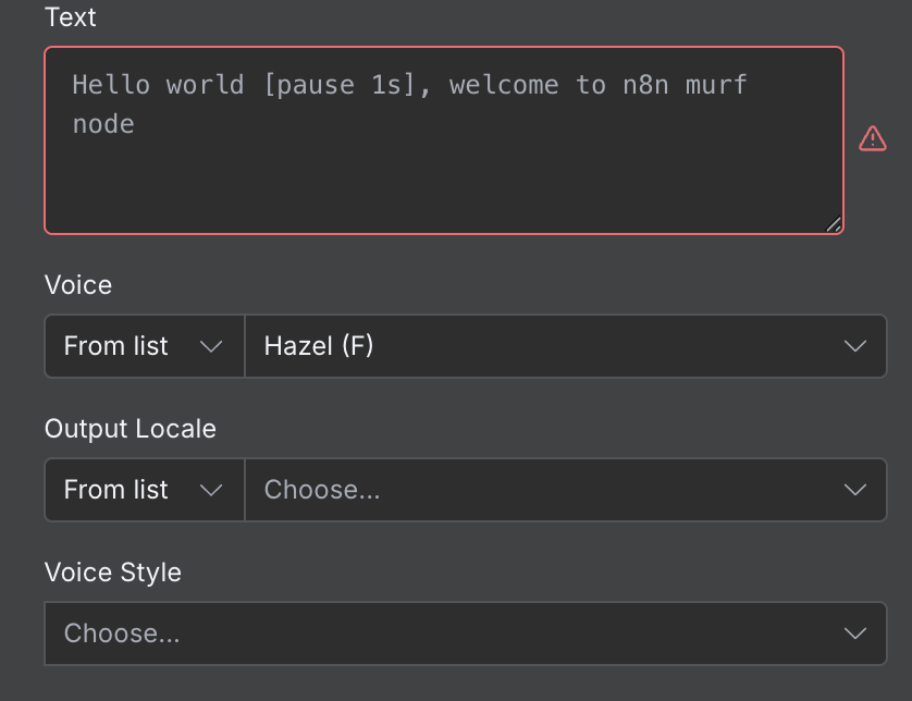

is it possible to reset the value of certain fields based on value of other fields
lets say in above description if voiceid changes then style and Output Locale should reset to empty can we have this kind of dynamic updation of input values

when you say changes, what do you mean? changes where?
in here if voiceid field value changes then style should be set back to empy if it has certain value before
I am sorry, I still struggle to understand both what you are trying to achieve as well as which node is on the screenshot. If you think you have explained the issue clearly and provided enough details, maybe wait for somebody else to answer in this thread.
Hi so what i am trying to achieve is to create a custom node for n8n. As part of it i am trying to build a specific action in my node and above screenshot is part of that.What i was trying to achieve can one field be made dependent on other .Currently from the docs i can see we can hide one inpt based on another can we change value as well.
I don’t believe there are listeners to achieve this, the closest you can get to dynamically setting the value is probably with loadOptionsMethod.
i tried loadoptions its creating a connection to load one field based on other but on ui though it cant change i.e clear before selected value
