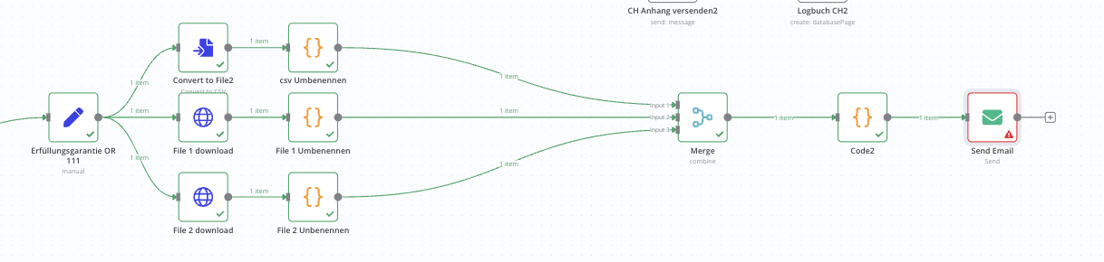

Here the Workflow:

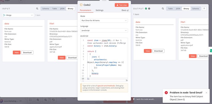

The item has no binary field '[object Object]'
This happens when I try to pass the list of binary fields dynamically (e.g. from a Code node).

I also tried to use Code like this
After that, I used the code in the send Email node: In the “Send Email” node I then tried:

You are on the right track.
Note that there are two modes the Code node operates in.
  • Run once for all items (your current mode) - in this mode you access all items in the input by $input.all() that returns an array of objects, where json and (optionally) binary properties are defined.
  • Run once per each item, under which you can refer current item props using $json and $binary references.
items is not defined giving you a hint.

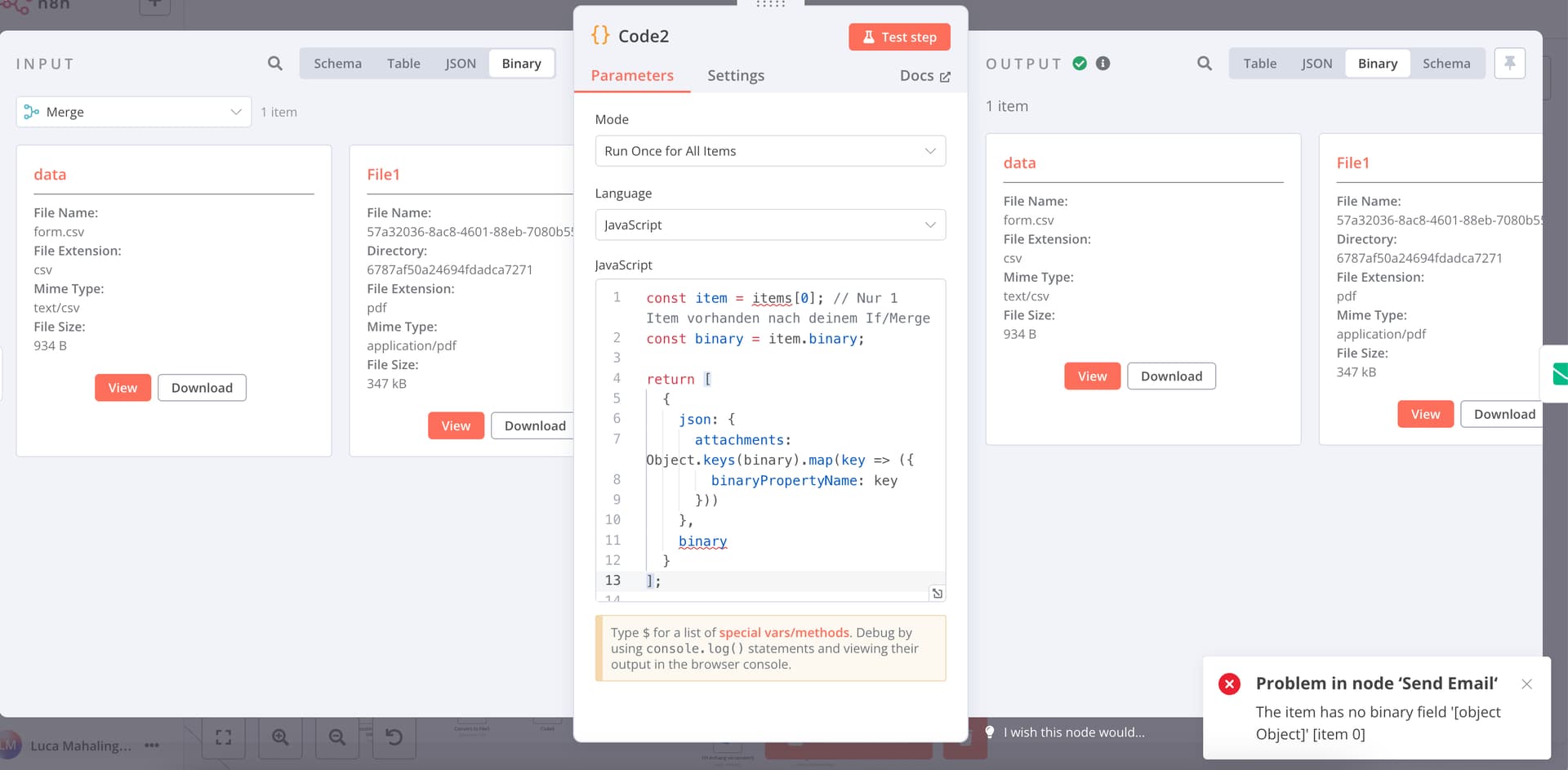

I used “Run Once for All Items” and accessed the input with $input.all()[0]. Then I passed the binary data through unchanged:
const item = $input.all()[0]; // dein einziges Item
const binary = item.binary;
return [{
  json: {
    attachments: Object.keys(binary).map(key => ({
      binaryPropertyName: key
  binary
In the Send Email node, I used this in the Attachments field:
{{ Object.keys($binary).map(key => ({ binaryPropertyName: key })) }}

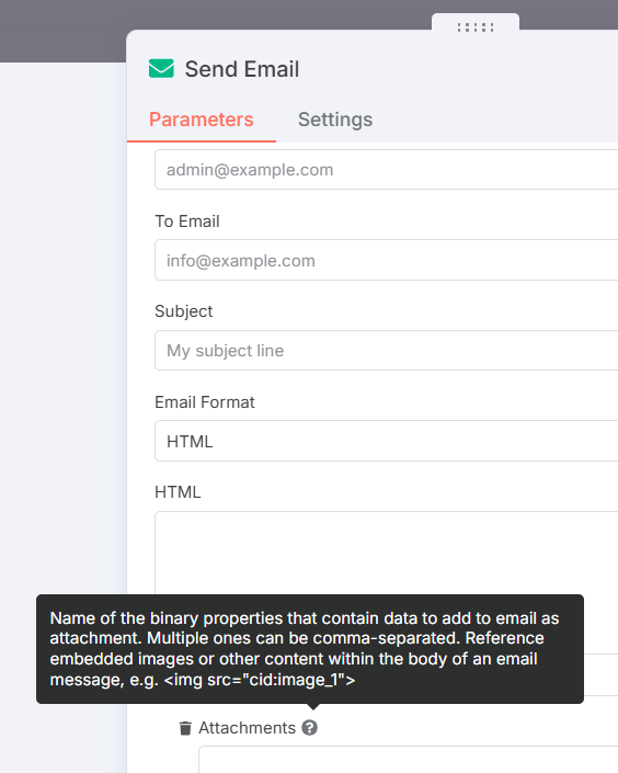

The attachments field expects a scalar value. With a hope that comma-separated list would work try {{ Object.keys($binary).join(",") }}

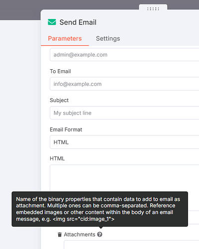

Does this look helpful?
