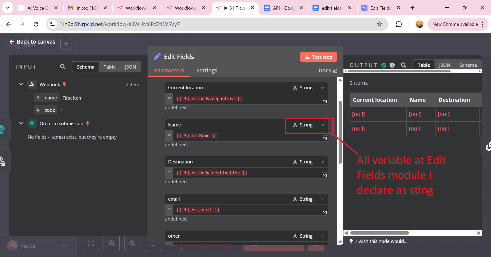

Edit Fields module output all return null?
Hi All

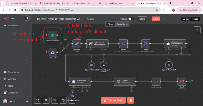

My work flow working fine when i am using webhook. Today i try to add on form submit .

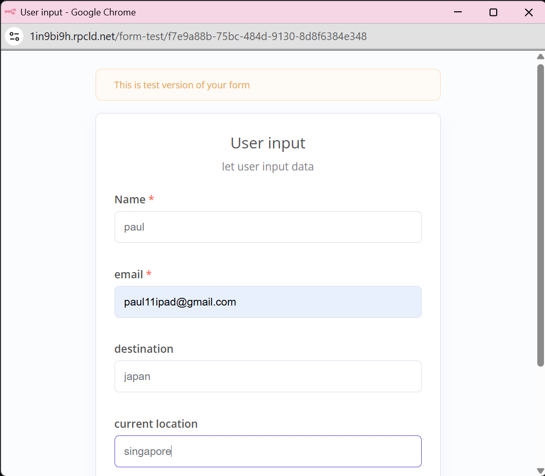

i am able to create a form allow user to input the data on : -
The output of the on form submit module is working fine as I can see all the data arrive at output :-

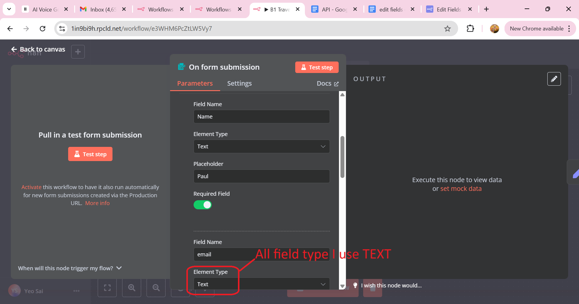

Remark :- on form submit , i declare all field variable type as TEXT.
Remark :- Edit field module , all variable declare as string.

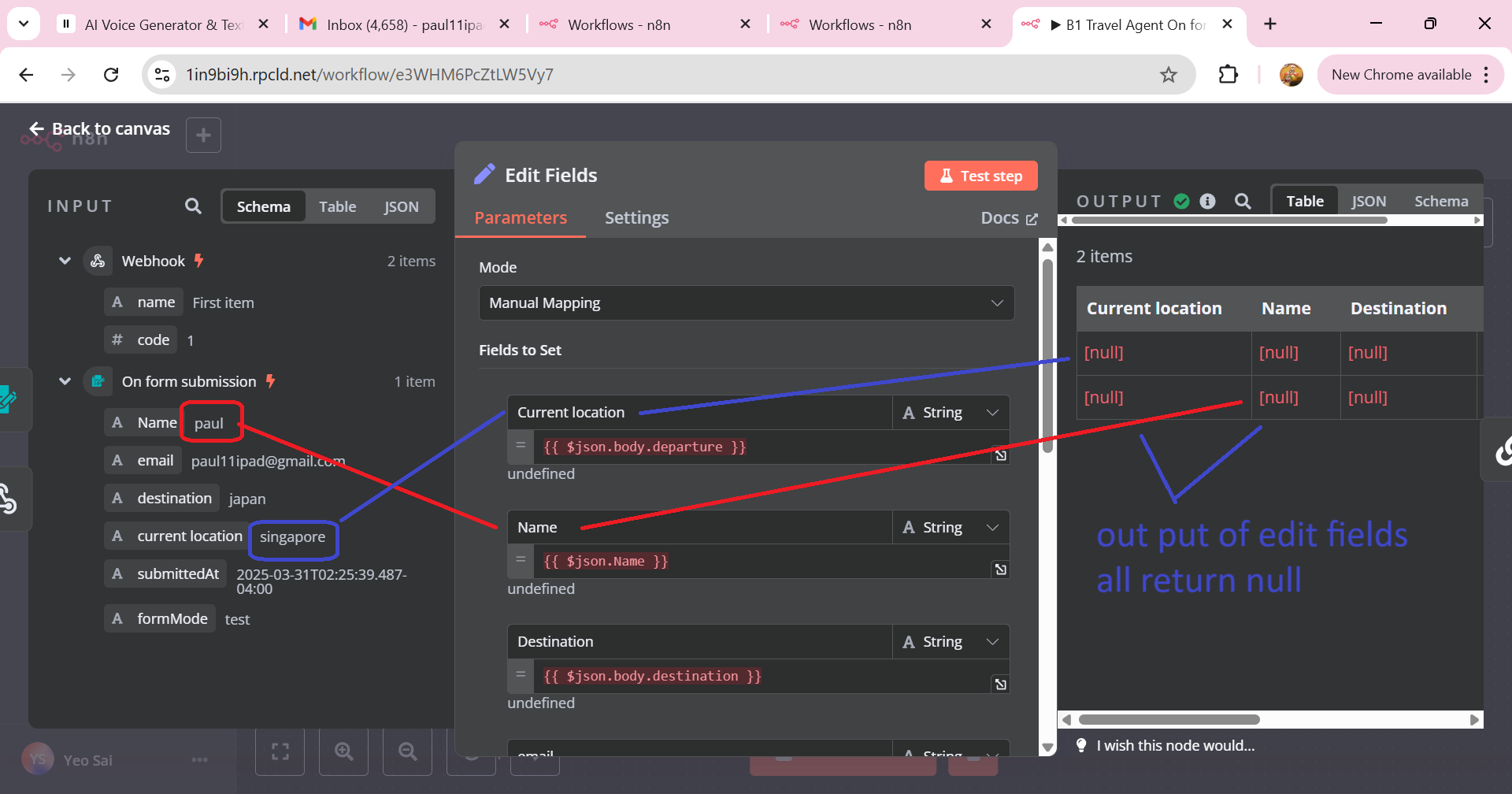

When i check on the Edit field module , i notice all out put field are null.
Hope some one can advise me where go wrong ?

So, from the last screenshot.
name and Name (caps difference) are different attributes. And the two items seem to be in reference to the two webhook calls. Which has none of those referenced attributes via the set fields node you show (why they are red and null). There is name but not Name nor body.
@ThinkBot Thank you very much . You are very sharp . In Webhook I use name , in on form submission is use Name.
When I arrive home I will replace on form submission from Name to name . Thank you
@ThinkBot Yes , you are right . I manage to get it work. Thank you very much .
