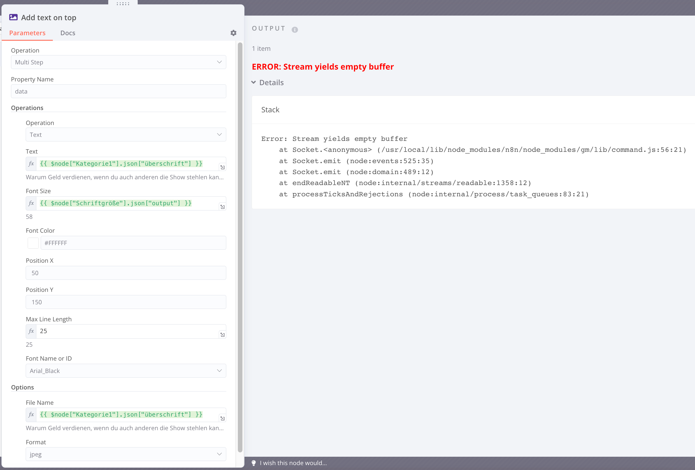

Edit image node: ERROR: Stream yields empty buffer
Trying to fill a number into Edit image note via normal expression, but strangly it’s giving out this error
Error: Stream yields empty buffer
at Socket. (/usr/local/lib/node_modules/n8n/node_modules/gm/lib/command.js:56:21)
at Socket.emit (node:events:525:35)
at Socket.emit (node:domain:489:12)
at endReadableNT (node:internal/streams/readable:1358:12)
at processTicksAndRejections (node:internal/process/task_queues:83:21)
  • n8n version: 0.228.2
  • Running n8n via - Docker:
Hey @ManyQuestions,
Are you using a custom docker image? Does the node work if you don’t use expressions?
Should be normal docker. Node works, when i enter a fixed number.
@ManyQuestions is the number actually a number or is it a string?
It’s the output of a function node.

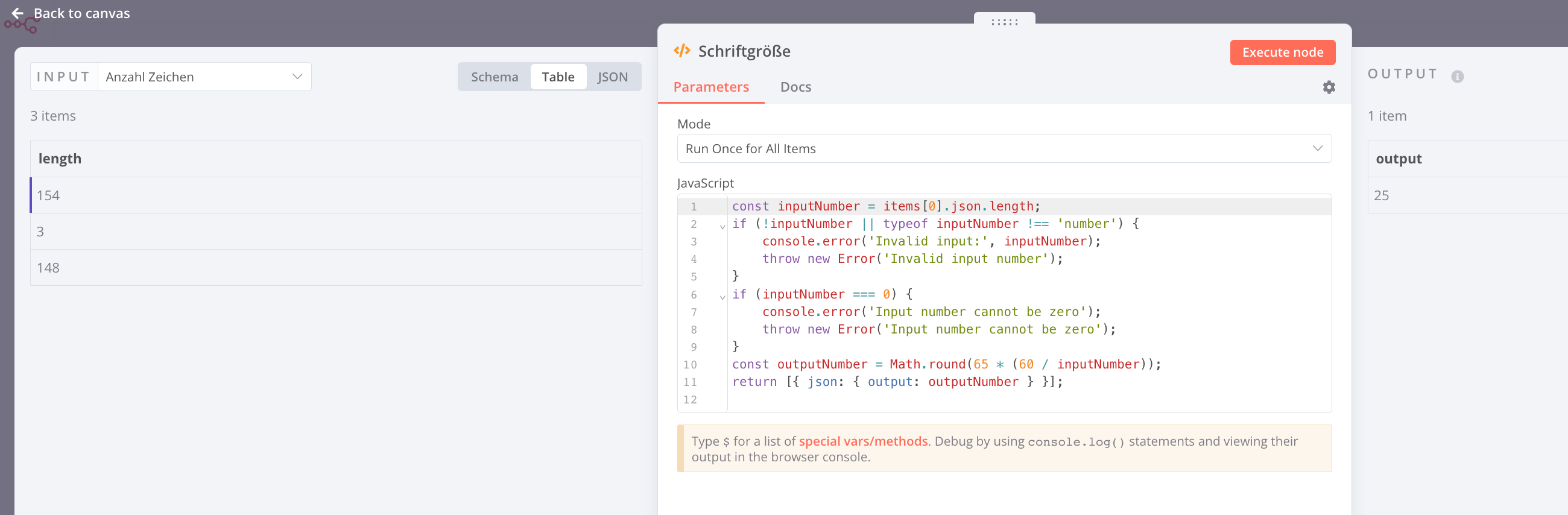

The number is coming from this code node. It’s caluation it, from the input number. Maybe it’s because the node is rounding the number. Not sure:

If i understood correctly, this expression in the edit image node: “.first()” is only working for the first item right? Is it possible, to have it take the text size number of the run for all output items of the text size node? It produces more than on item. (i changed the workflow a little.). I tried “.all()” instead, but it’s not working.
@Jon So i realized that it’s taking the different numbers of the runs correctly, when i enter:
{{ $json[“output”] }}
But when i enter:
{{ $node[“Text size1”].json[“output”] }} , it is only taking the last number.
In my production workflow, the nodes are not next to each other. So that’s causing the issues.
