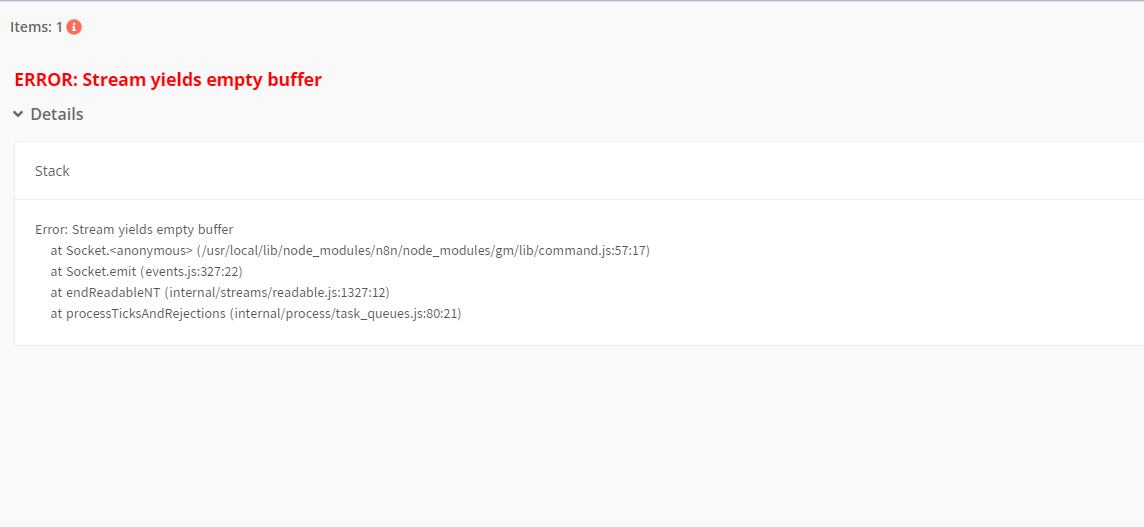

Edit pdf using edit image node
Hello, are we able to edit pdf using image node?
I tried and i am getting the following error.

Hello @jan , i have tried the test workflow and i am getting below error.
i am using docker install ( self hosted using ubuntu ). version. 0.160
By the way, do i have to install anything on my ubuntu server or declare certain variable docker-compose.yml?
Sorry, that was my mistake. It does not seem to work with the default images n8nio/n8n:0.160.0 or n8nio/n8n:latest which are based on Alpine Linux.
For it to work you would have to use the Debian based one n8nio/n8n:0.160.0-debian or n8nio/n8n:latest-debian.

I found the difference using google search… now i have switch to debian based and it is working. :grinning:
