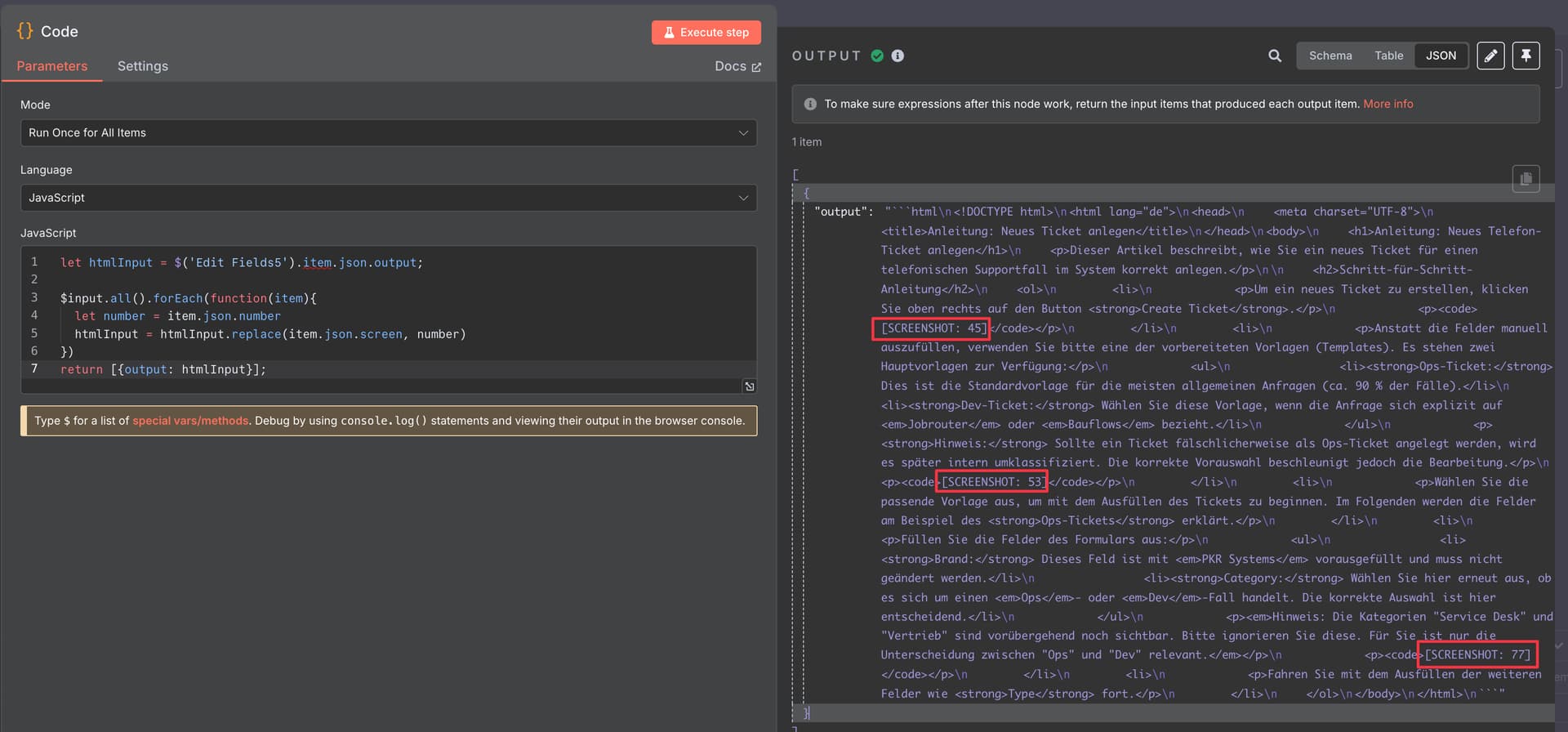

Here is the flow:
At the end of the Loop1 I do need only one text with all replaced items. Hopefully that helps.
I can not find a way to do it without code node.
So here is my solution
This is your expected result right?
@darrell_tw, thank you very much! I already doubted that the code node is necessary.
Thanks for your help and pointing me in the right direction!

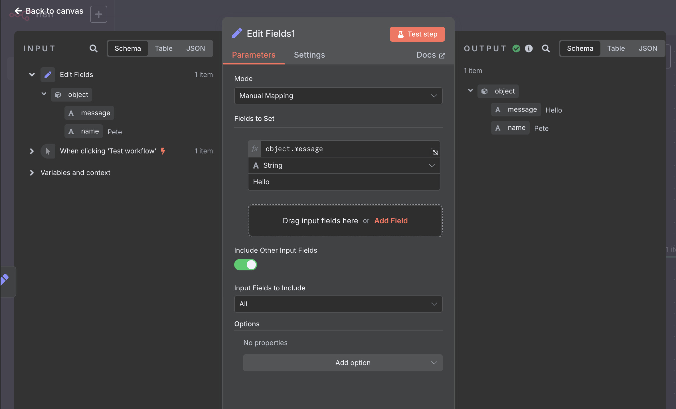

I also always use the code block, but you can do it with a set node like this.
The key things to keep in mind is to reference the field using dot notation object.message so it matches the position of the original object and then enable the "Include Other Input Fields option
It might work in my simple example, BUT in more complex workflows the code block should be used to easily reference previous nodes by name like in @darrell_tw solution
