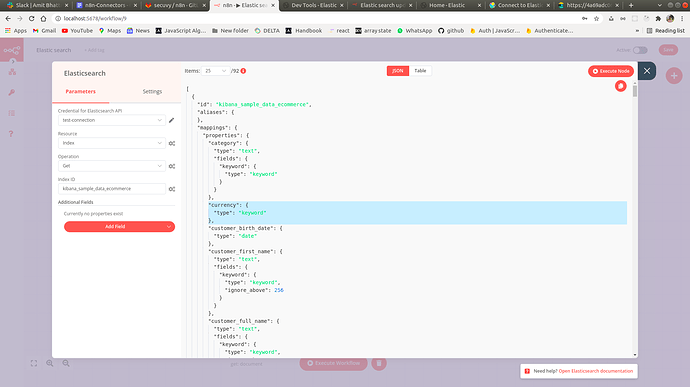

No I did not change any instance, last week I was able to get the sample data of e-commerce deployment from elastic search node whereas now I get the schema that was used to build the data.
I have shared the screenshot of the current response I get from e-commerce deployment

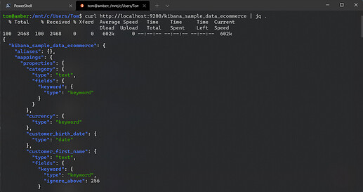

Hi @LENINDALLAS, from your screenshot it looks like you are fetching the index rather than the documents in the index. The result you see in n8n matches the response provided by the corresponding Elasticsearch API endpoint:
If you’d like to see the documents you’d need change the Resource to Document in the Elasticsearch node on your screenshot:
