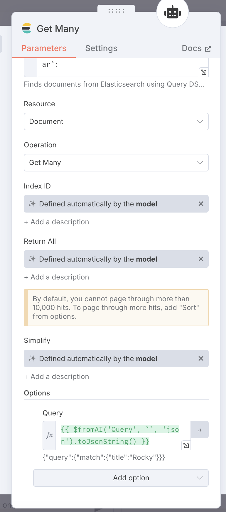

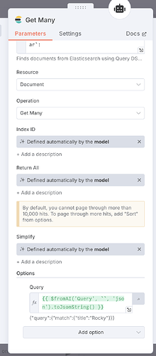

you can do this with node elastic search instead of using HTTP Request.
{{ $fromAI('Query', ``, 'json').toJsonString() }}
