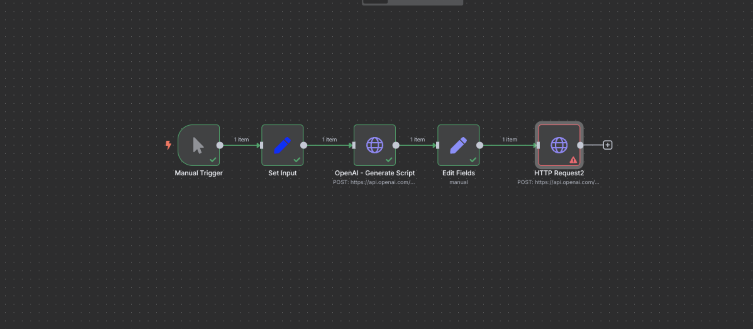

Hi I’ve been trying to build a workflow to generate some AI videos with Elevenlabs voice over but I don’t know how to add it to the Http node. Anyone familiar with how to set one up? I’m asking chatgpt but it’s leading me in circles. Thanks for the heads up! Here’s what my current setup looks like. Everything is working except for the last Node which is supposed to generate the voice.

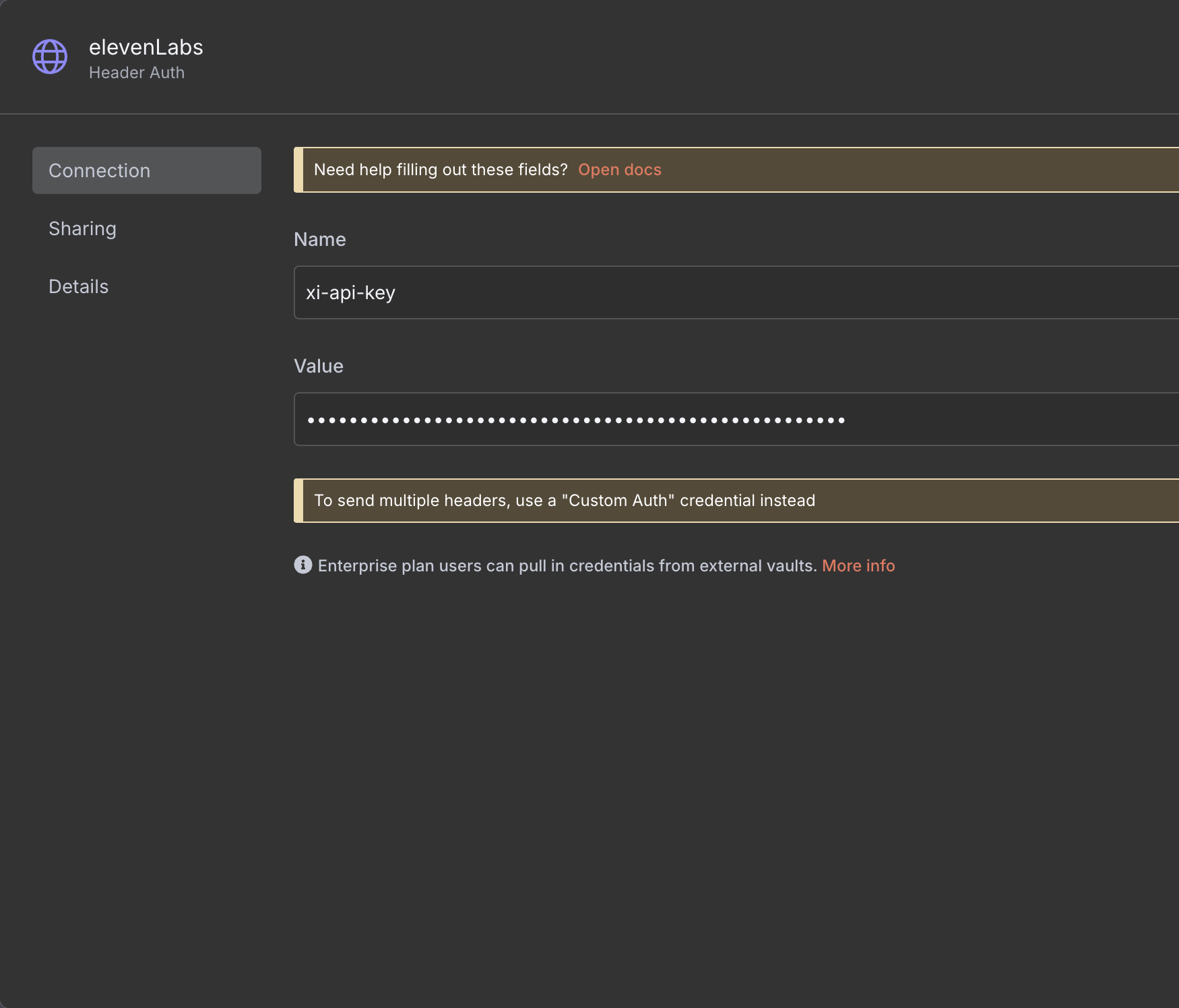

  1. First generate an API Key in elevenlabs
  2. Setting the credential in n8n
    Header auth
    name is : xi-api-key
    value is the api key just generated
    sk_xxxxxxxxxxxxxxxxxxxxxxxxxxxxxxxx

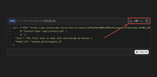

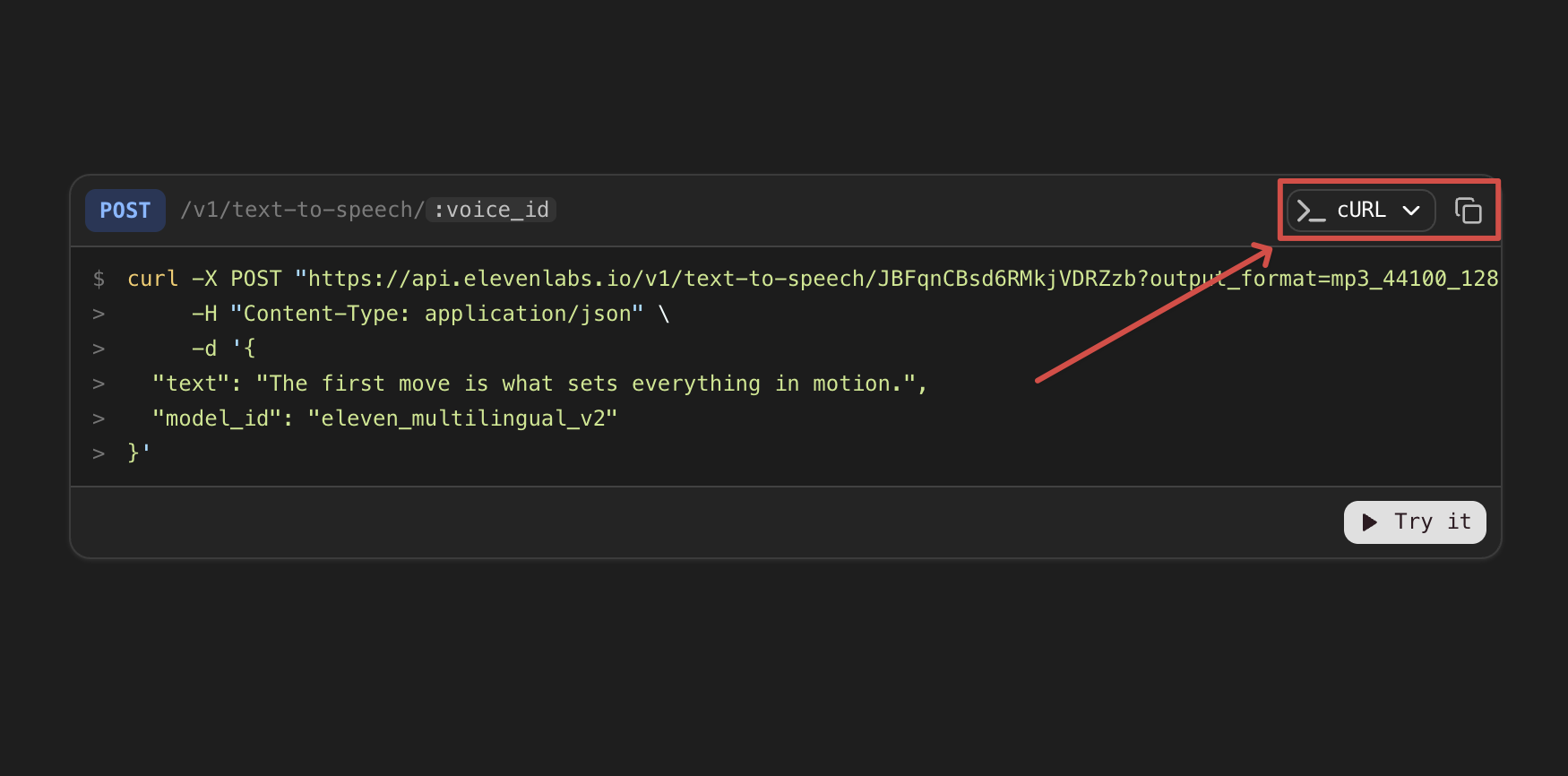

  3. Go to the API reference. Check which API you are interested in.
Copy the CURL in the document

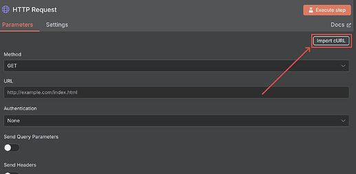

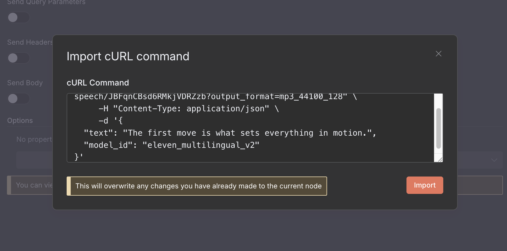

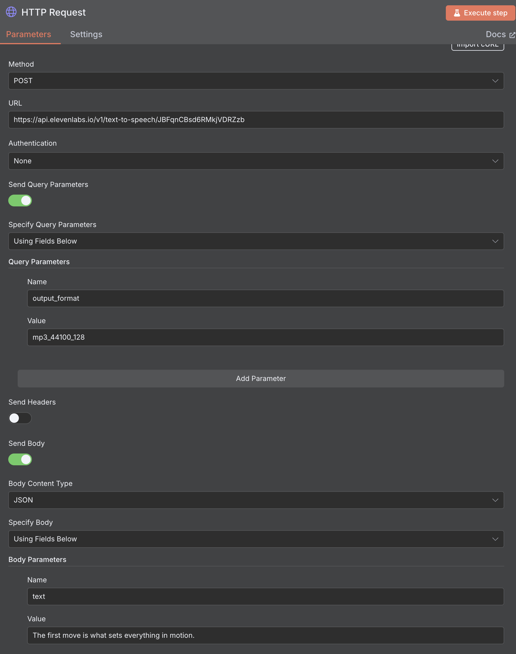

  1. Back to n8n. Create a Http Request node and select import from curl

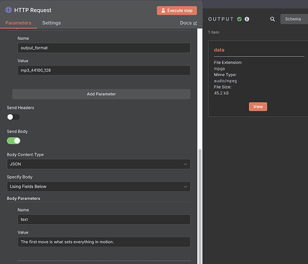

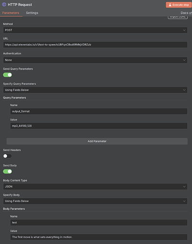

  1. Try not to modify things in the first test.

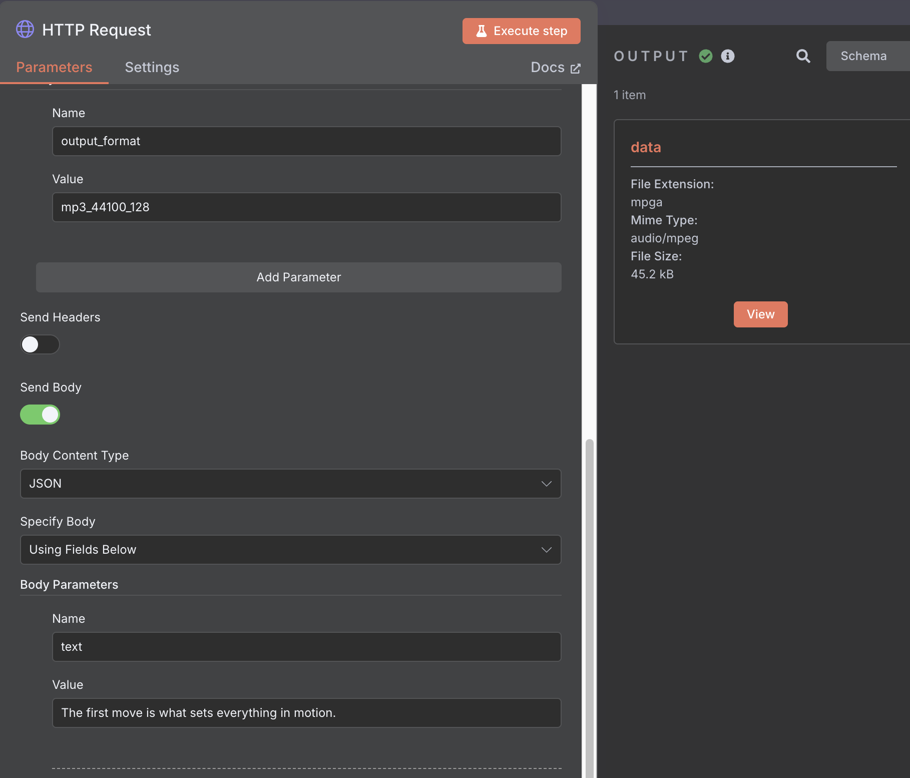

  2. Send. You should see the mp3 file as output.
@darrell_tw Thank you!! You’re a genius, I got it to work with Chatgpt!!
I was able to got it to work. Thanks for reaching out!! I’ll reach out if I ever have any questions regarding Elevenlabs.
