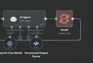

I have a workflow with a agent the creates draft emails. Works fine when 1 item is pulled via the gmail trigger node.
The problem is when 2 or more items is pulled from gmail. Then the first email body is created for all emails.
It is super weird because when I look in the create draft node the input email body is different for run 1 and 2, but still email body from run 1 is used for run 2 also (see attached images).
You can also see in the images that the output from the create draft node looks different in run 1 and 2, even doe the input is “subject” and “emailbody” in both?

I have the same issue. Adding the draft email creating as a node instead of the tool solved it for me. but i think this bug should be fixed asap because it’s not clean to do it like this and your error margin becomes bigger.
