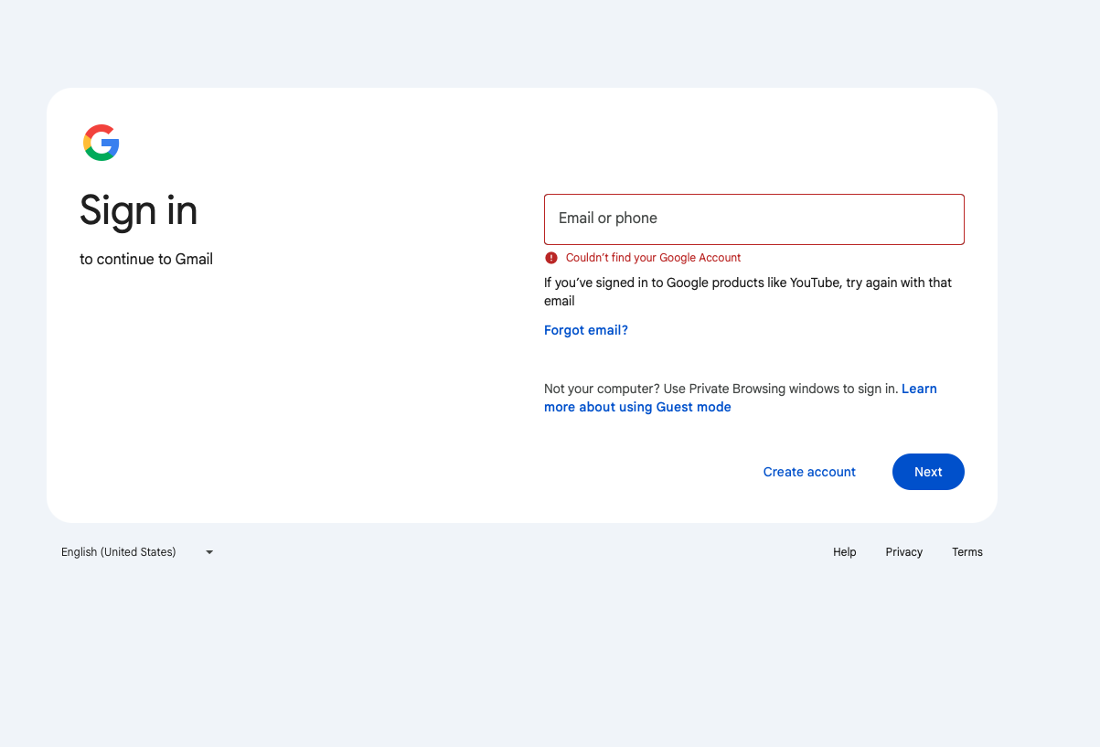

Hmm, its not really 2 credentials.
In the end, when I am going to login to my google account after setting up Client ID and Client Secret–I cannot login with an alias account (I THINK).
