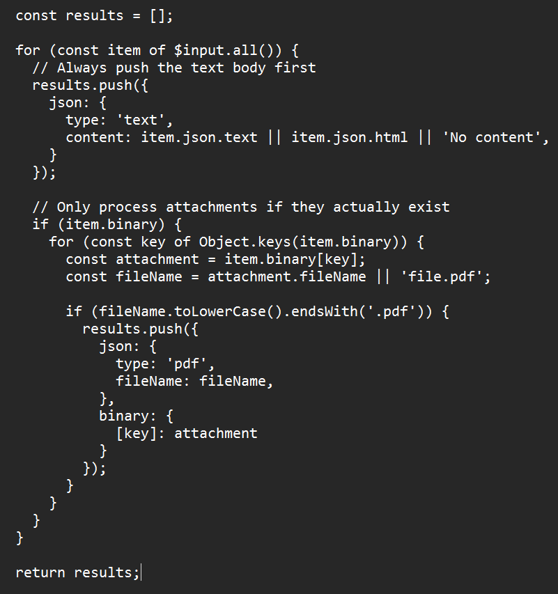

achamm
February 7, 2026, 8:55pm
9
Hey @Arusha Try this! - Also ensure your telegram node can receive binary like it is set to be able too.
// Get items from the previous node
const items = $input.all();
const results = ;
for (const item of items) {
// Safely get the body text
const bodyText = item.json.textPlain || item.json.textHtml || item.json.text || ‘’;
// Send body as a text message
results.push({
json: {
type: ‘text’,
content: bodyText,
// Safely handle attachments
const attachments = item.json.attachments || item.binary || {};
for (const [key, attachment] of Object.entries(attachments)) {
// Guard against undefined properties
const mimeType = (attachment?.mimeType || attachment?.contentType || ‘’).toLowerCase();
const fileName = (attachment?.fileName || attachment?.name || ‘’).toLowerCase();
if (mimeType === ‘application/pdf’ || fileName.endsWith(‘.pdf’)) {
results.push({
json: {
type: ‘pdf’,
fileName: attachment.fileName || attachment.name || ‘document.pdf’,
binary: {
data: item.binary?.[key] || attachment,
return results;
Hi @Arusha , welcome to the n8n community ! From what I can see, the crash happens because the Code node is calling toLowerCase on items that do not have a fileName, such as the email body. To fix this and make sure both text and PDF attachments are sent correctly, I would replace the current Code node with the setup below
After that, I would use a Switch node to route text items to Telegram Send Text and PDF items to Telegram Send PDF using the binary property data. This avoids the crash and handles emails with or without attachments reliably.

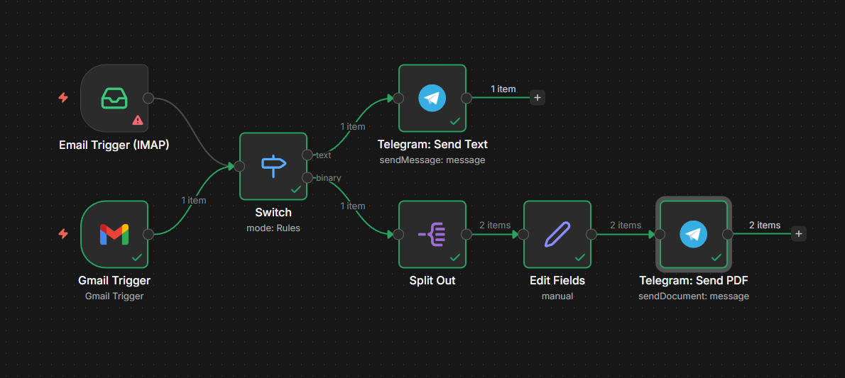

Hi @Arusha ,
I think this is simpler than using a Code node,
From what I can see, the issue is with the Switch node, it’s either bugged/outdated or not configured correctly,
However, if you ask me for the simplest no-code way to do this, I would do it like this:
Note that I tested it with Gmail; it should work with IMAP as well:
Feel free to edit this workflow as needed.

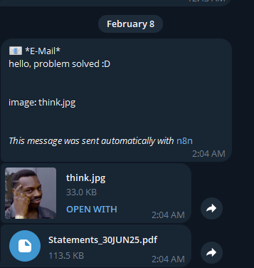

Arusha
February 8, 2026, 6:53pm
12
Hello, unfortunately I can’t test your tips today because I don’t have access to my N8N on the go. As soon as I have access again, I’ll report. But thanks for your effort in advance.
Arusha
February 11, 2026, 10:24am
13
Okay, so he sends me the PDF, but not the content of the email
Sent from gmx to mailcow.
So not Gmail.
