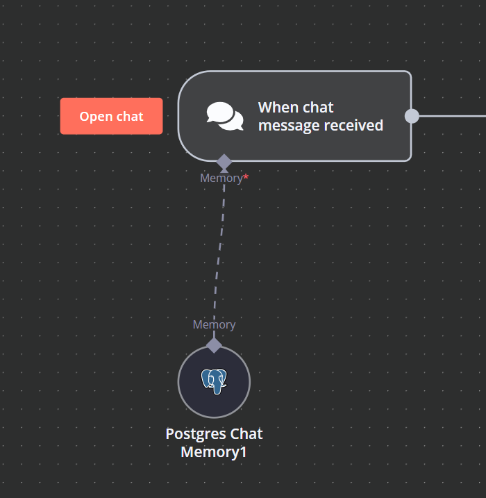

I set the option to 10 last messages from the chat history (for the chat trigger node). But the entire chat history is still read. You can see it on the page in the browser. There is all the past correspondence, not just 10 entries.
By the way: For the “AI Agent” node, the memory depth setting works correctly. If you set 10 entries there, then on the 11th question he begins to forget what he said at the beginning of the conversation.

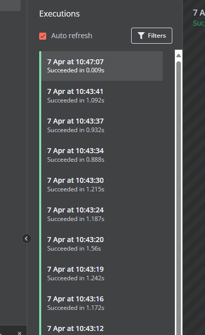

When we refresh the page (but do not yet open a dialog with the AI ​​agent), the browser already reads the entire chat history. The browser accesses this via the specified web hook. This is not visible in n8n! That is, it is not displayed in the “Executions workflow” logs. Why is that? This complicates debugging.
By the way, when we ask the first question to the AI ​​agent, this action gets into the “Executions workflow” logs. And then you can view this action in detail.
