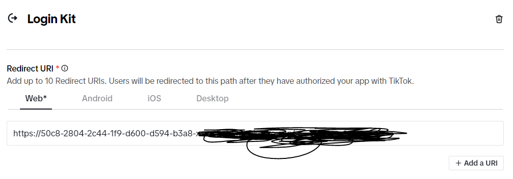

Enter a valid URL starting with https://
I’m trying to put the redirect url on TikTok, however, it doesn’t accept the format http://localhost:56xx/

Just updating, I had a similar problem with Facebook, the webhook url didn’t receive anything, I tested it in a tool with a public url and received it, then I discovered that it didn’t work with localhost, so I used ngrok to create a public url. It worked on Facebook. The url was accepted on TikTok, but I haven’t tested it yet, but it will almost certainly be ok.
