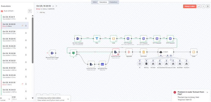

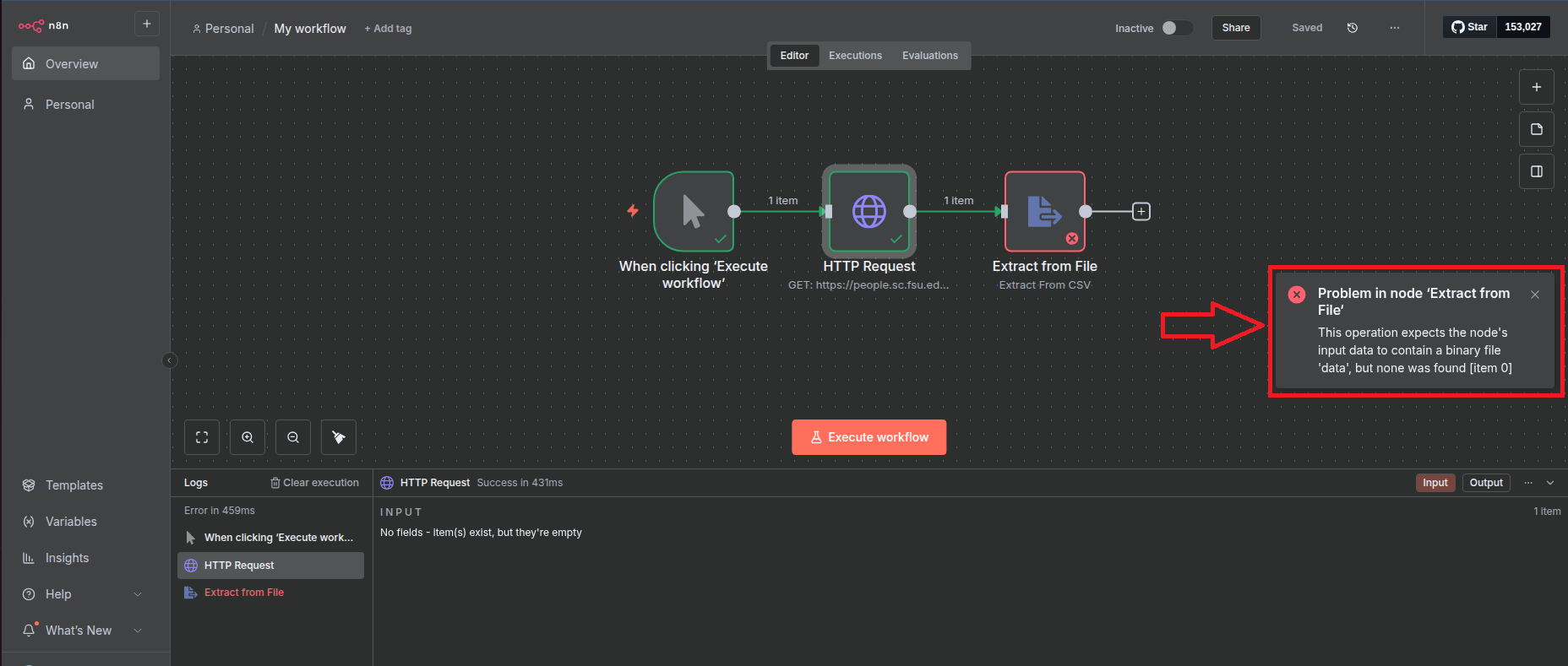

I have tried to reproduce the error that you’re facing on my end by testing out the “Extract from File“ node by receiving data from a test HTTP Request:

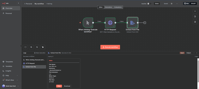

The Extract from File node is failing because the data from your previous node isn’t passing the uploaded file as binary data. To fix it, it’s important to receive the data as a binary file. I see that you are using HTTP Request nodes. The error on your end means that the node couldn’t find the binary file field named “Arquivos”. You need to select the Response Format as “File” and then the exact same name for “Put Output in Field” will go as “Input Binary Field” for the Extract from file node. In my case it is “data”:
