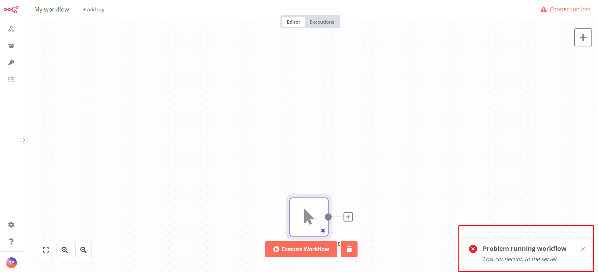

Hello, I’ve installed n8n at least 20 times in 3 differents domain and I’m gettinr Connection Lost error.
as you see: Screenshot by Lightshot
I try to install on diffents ways. I try direct at digital ocean and not worked.
After that I try using cloudron, didn’t worked too.
So I tought was the server and I try at vultr, didn’t work too.
I even try to install on different domain and didn’t work. Can you help please?
n8n version:0.216.1
Database you’re using (default: SQLite):
Running n8n with the execution process [own(default), main]:
Running n8n via [Digital Ocean, cloudron, cloudflare]:

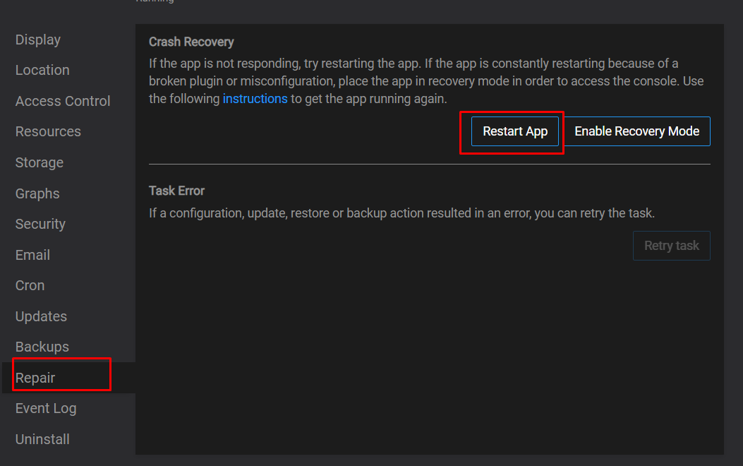

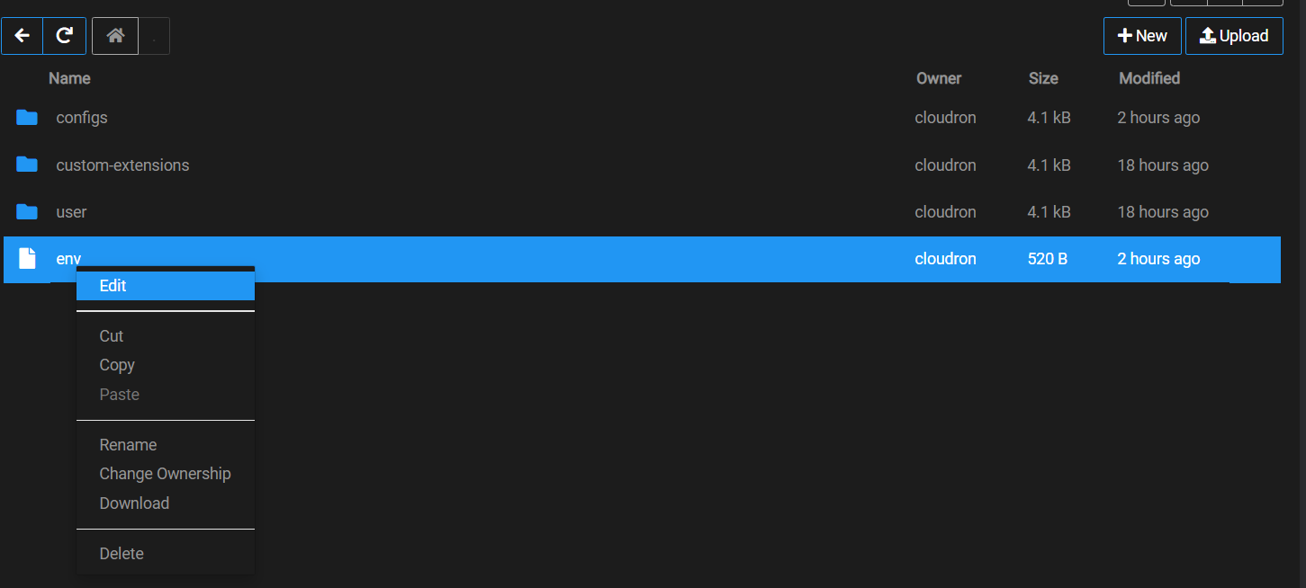

I’ve follow the steps belows
1- I’ve opened the Cloudron and click at n8n app
2- I’ve clicked on folder icon.
3- I’ve open and edit the env file
4- I’ve insert the code below and save the document.
export N8N_PUSH_BACKEND=websocket
5- I’ve restart the app
