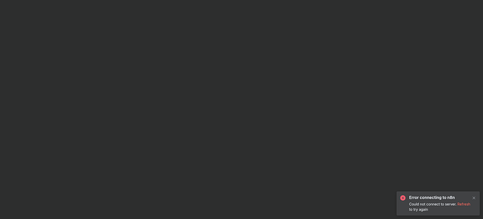

After updating my N8N instance to the latest version, every workflow (old or new) throws the following error whenever I try to do anything:
Error: window.crypto.randomUUID is not a function
I tried running window.crypto.randomUUID() directly in the browser console and got the same problem.
Environment Details:
N8N Version: 1.120.1
Deployment: Local (http)
Operating System: N8N on a Windows and my PC is Linux/Debian.
Browsers tested: Chrome, Mozilla Firefox
Strange behavior:
I cannot access my local N8N (HTTP) instance using one profile on Chrome or Firefox—the UI gives a connection error (see attached screenshot).
On another Chrome profile, the same local HTTP instance works fine.
N8N Cloud works normally.

I logout on the only working profile and now i’m getting the same error for all profiles
Same issue after updating to 1.120.1.
I also tried logging out and back in but now I cannot even log back in because of the issue.
Same issue here.
i can’t copy any node or even start using a new one.
I tried different browsers
running N8N 1.120.1 as a docker container

”Error connecting to n8n: Could not connect to server. Refresh to try again”
when i downgrade to 1.119.2. it turns fine

I have fixed this issues
“window.crypto.randomUUID is not a function” and cannot access local WebUI
By installing the proxy server and gen a cert for a IP to make the HTTPS connection, and using the ghcr.io latest docker images instead of using dockerhub images, weird but worked.
