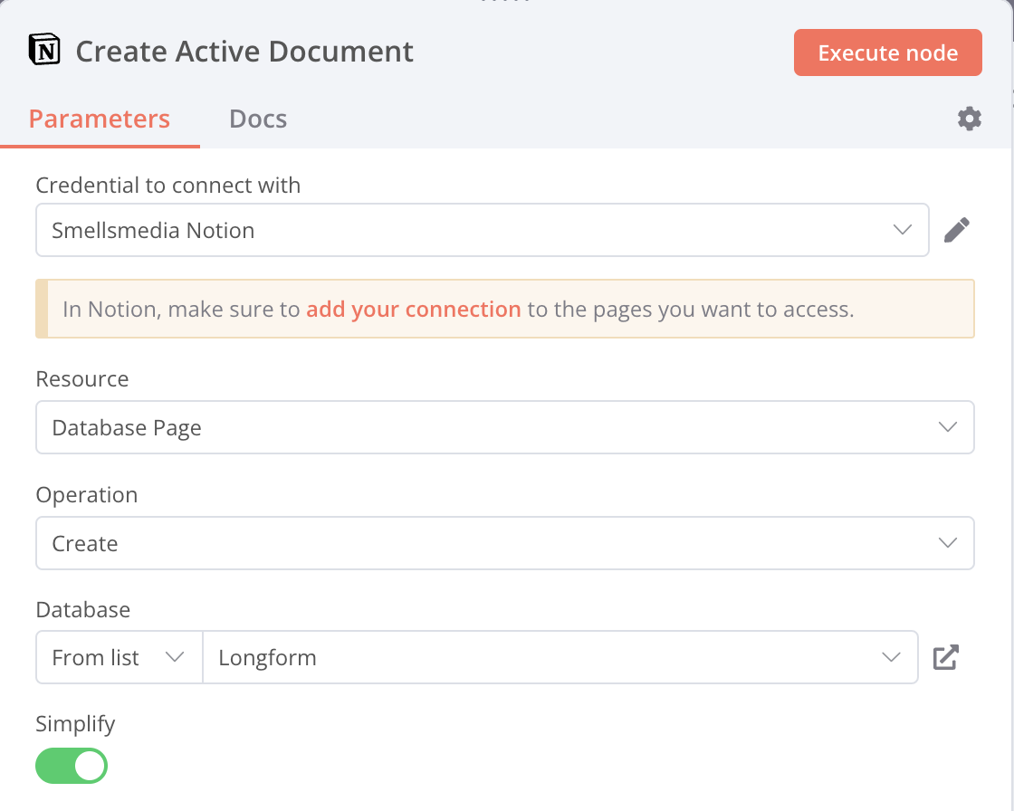

I think I figured it out. I think it’s a bug.
After changing the node parameters I think the “Title” field disappears. Here’s what it looks like when the node is freshly added:
Here’s what my node looks like after changing some params:
Hi there @smellsworth - sorry to hear you’re having trouble with this!
I’m not able to replicate this on 0.231.2 at the moment - I created a new page and tried to add as many parameters to send as I could over in properties, and it worked just fine:
Are you able to provide any further troubleshooting steps to test this out?
