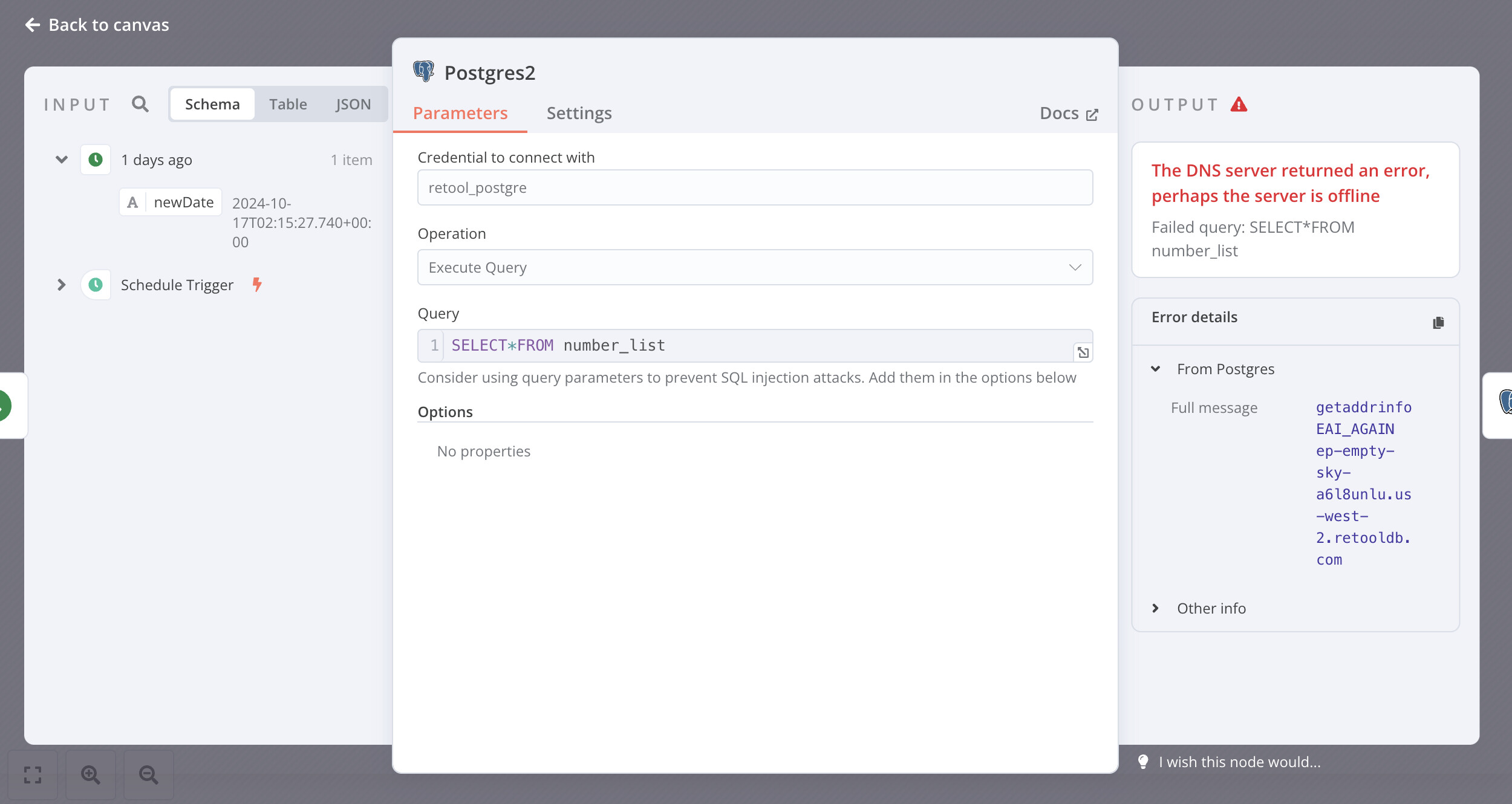

Sometimes, my n8n workflow encounters an error: “The DNS server returned an error; perhaps the server is offline.” This occurs randomly, lasting for 30 to 60 minutes before returning to normal without any errors. During the error period, my n8n cannot make any HTTP request.

I may have found the reason for the issue and a solution. I hope to share my findings here, as they may be useful for other n8n users.
Error Reason
The problem stems from the Vultr server, which uses its own DNS resolvers. You can find more information in the Vultr documentation:
For IPv4, it uses 108.61.10.10 to translate addresses like sample.com to an IP address, such as 123.456.12.89. However, Vultr’s DNS resolvers are not stable and often fail to translate sample.com to an IP address. As a result, the n8n instance cannot reach the API endpoint, as it is unable to locate the IP address.
How to Solve
In the Vultr server console, log in and run the command:
resolvectl status
This should show that the DNS Server in use is 108.61.10.10. To fix the issue, change the DNS Server from 108.61.10.10 to 8.8.8.8 (Google’s DNS resolver).
Open the configuration file with the following command:
sudo nano /etc/systemd/resolved.conf
Then add or edit the following lines:
[Resolve]
DNS=8.8.8.8 8.8.4.4
This will set Google’s DNS as your preferred DNS resolvers. That’s it!
