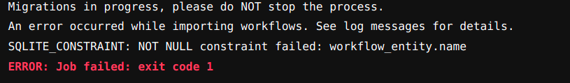

I am not able to import workflows and creds.
Here is the issue,
In local also not working.
I am using the n8n version is + n8n@0.168.1
My import command is,
n8n import:workflow --separate --input=/home/xxxxxx-g/workflows/
n8n import:credentials --separate --input=/home/xxxxx-g/credentials/
Thanks.
From looking at the error message it seems you are trying to import a workflow with an empty name. How does your workflow JSON file look like? Are you able to import it manually through the UI for example?

I’ve just tried this on my private instance and the command was working for me as expected I am afraid. Do all your workflow files have a valid name?
Does the import work if you use the UI to import a workflow?
Can you import individual workflows rather than all of them (= the CLI command without using --separate)?
@MutedJam which version of n8n did you test?
a single file can import, but all not working. even names are valid.
I figure out only in CLI not UI.
I’ve just tested running n8n import:workflow --separate --input=/storage/ using the latest n8n version 0.168.1 (I was previously using 0.168.0) but did not encounter the error you have reported I am afraid. So I’d very much think the problem lies within one of your JSON files.
You could try moving all but one of the JSON files out of your folder, then retry the import. Then move a few files back, try importing again and so on until you identify the problematic file.
It’d then be worth taking a closer look at the problematic file to see what’s wrong with it.
