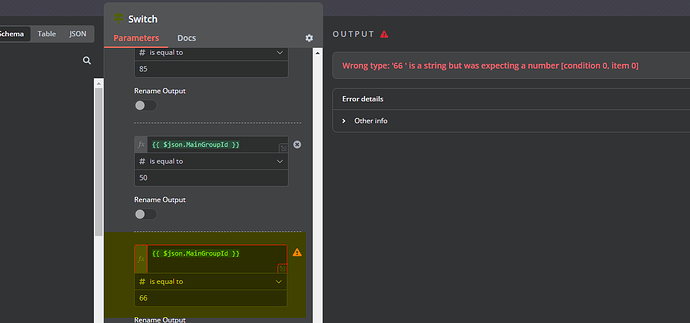

i have a ling switch node with numeric values, but suddenly i get this error.
obviously all are numeric values

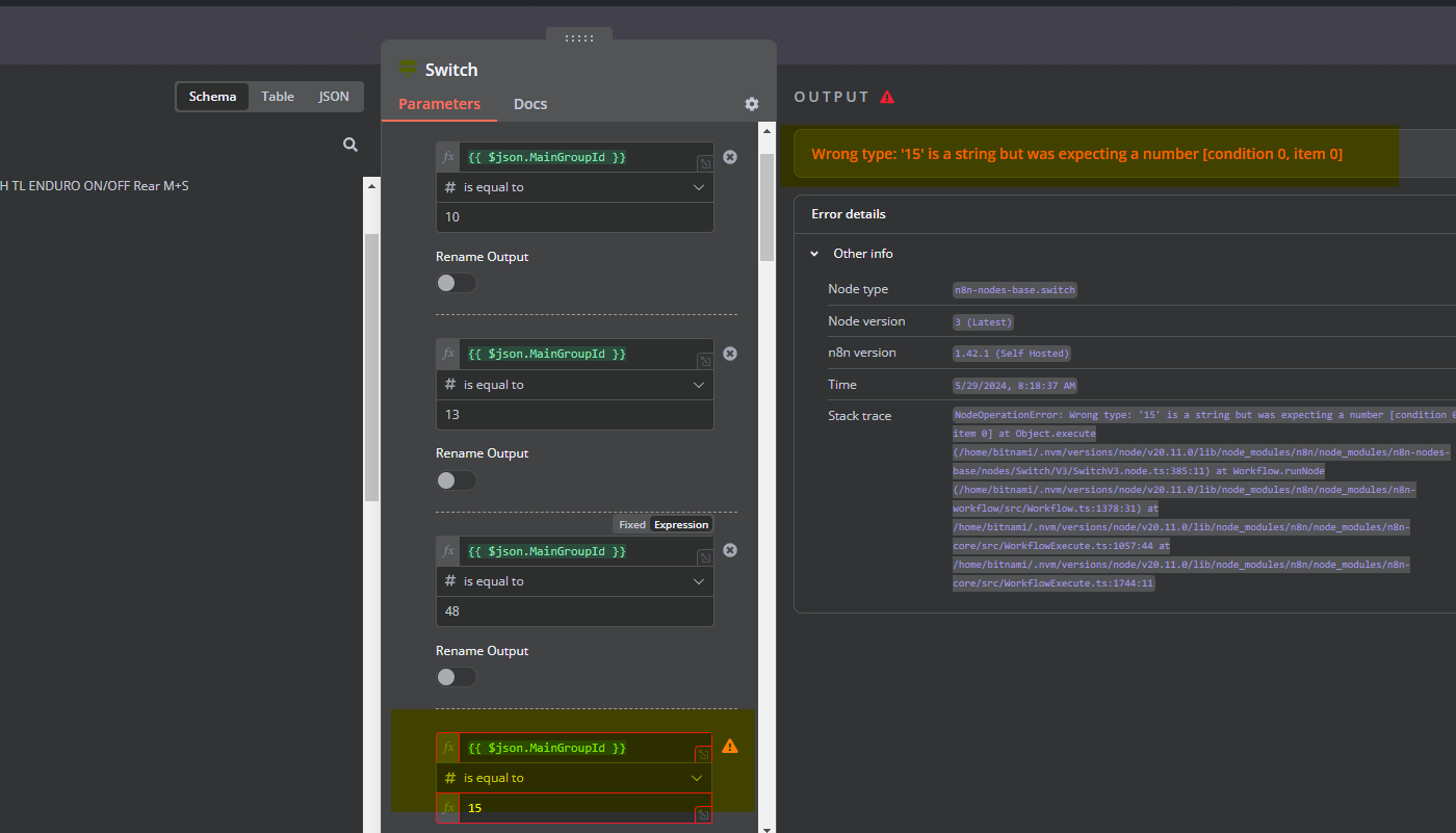

It is set as an expression. If you set it to fixed it should be fine.
Or put {{ }} arround the 15 to make it a number again.
thank you , for some reason it went into exec mode ![]()
looks like Less Strict type validation helped
