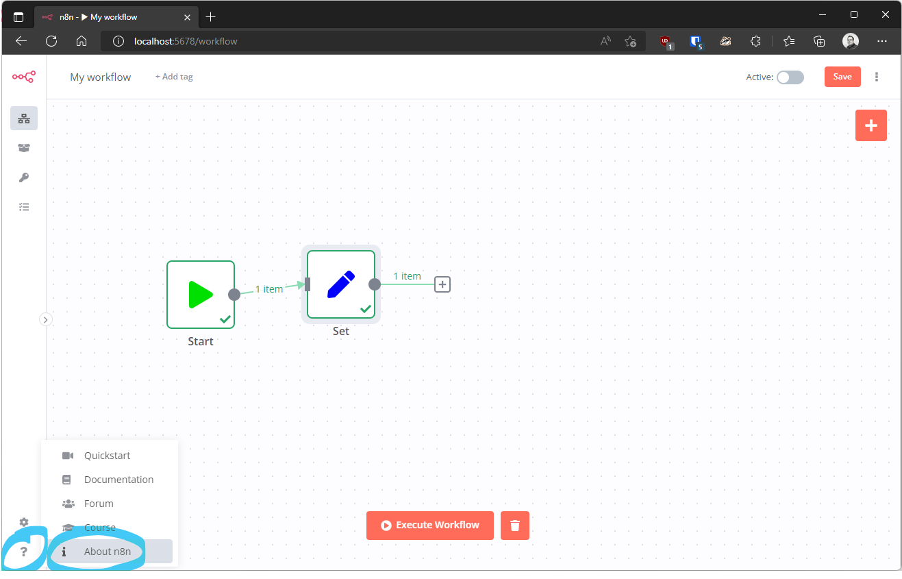

As for the n8n version number, you can view it like so:
