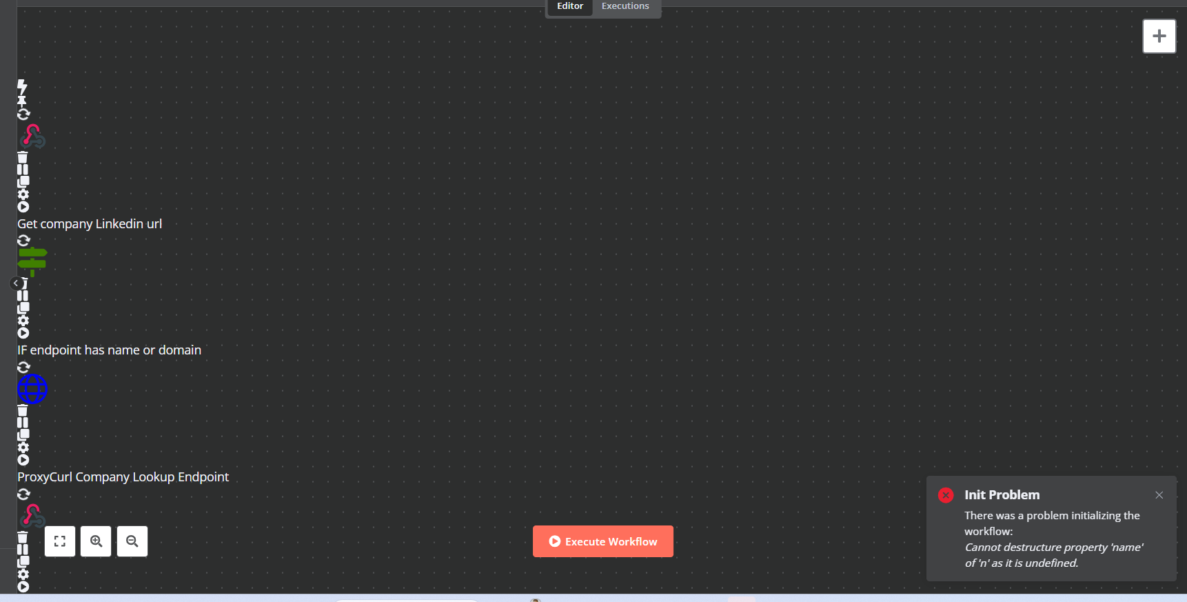

Error message:
Init Problem
There was a problem initializing the workflow:
Cannot destructure property ‘name’ of ‘n’ as it is undefined.
Error screenshot:

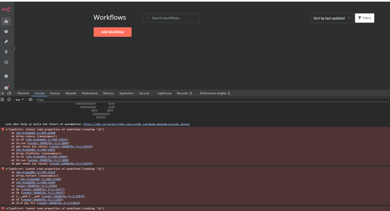

Console error:
From the Console logs, it looks like the problem is with the many nodes (Item Lists, Hubspot, HTTP Request, Postgres).
Also in the logs, we can see Array.forEach mentioned and I have seen “Init Problem” just like above with “forEach” mentioned (if I catch that, will update the post):

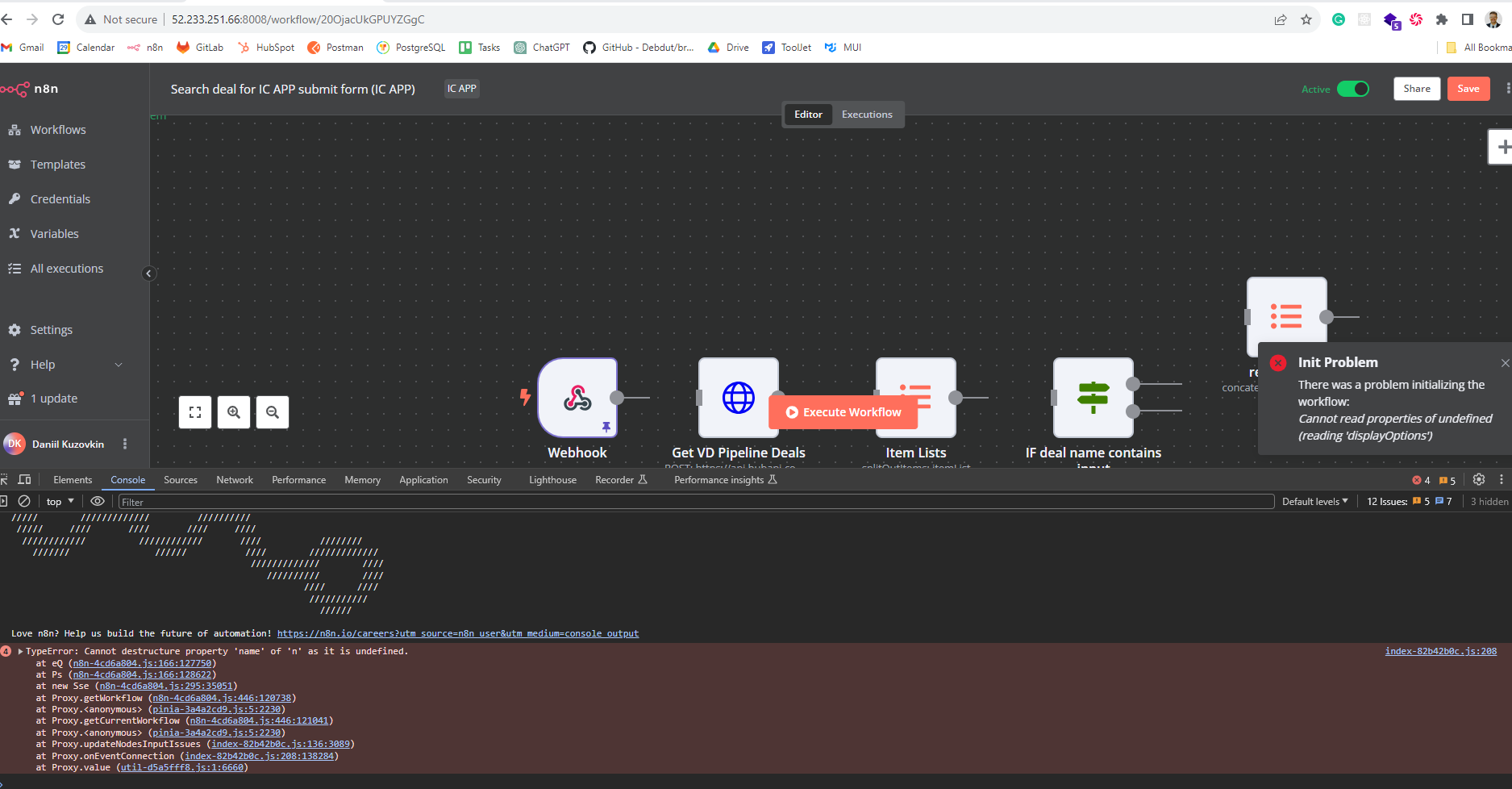

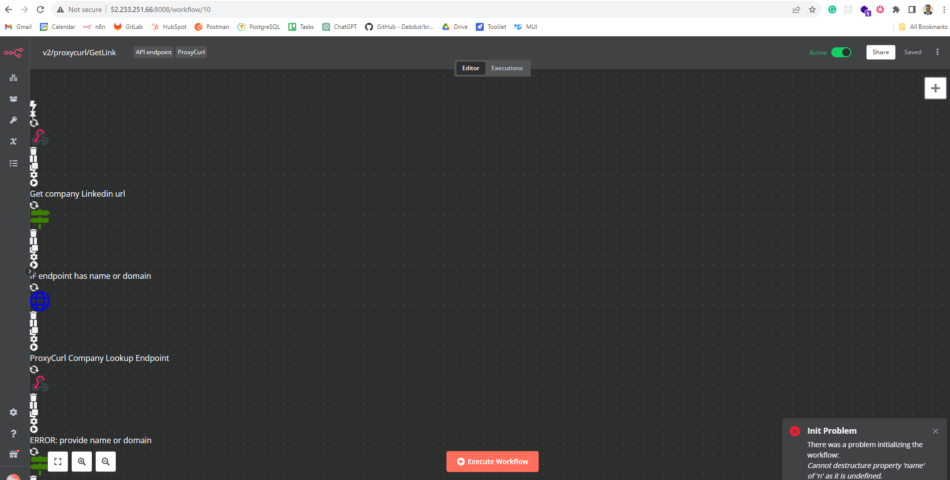

@Jon Here is the error without nginx in the middle:
In the first comment I said that I have seen some other errors, and here is one of them - DisplayOptions (also without nginx in the middle):
Init Problem
Cannot read properties of undefined (reading ‘displayOptions’)
