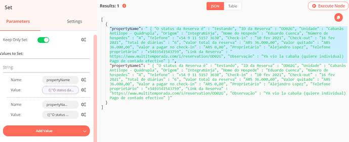

Hello guys, im trying to pase a json with:
return [{json:{new_value:JSON.parse(items[0].json.propertyName)}}];
but im geting this error: ERROR: Unexpected token in JSON at position, but this only happens when I put it as an expression of an output.
When I try to perform the same process but using a manual variable with the same json body, works normally
I created two variables one coming from the text of imap, is a json.
Another, I put the json manually in the variable to test.
When
output error
but, when
return [{json:{new_value:JSON.parse(items[0].json.propertyName1)}}];
Works
My question is: why can’t i convert to json if the text is identical?

Hey @Alexandre_Magno!
The propertyName is already a valid JSON. You’re trying to convert a JSON into a JSON and that is the reason why you’re getting the error. propertyName1 isn’t a valid JSON, it is a string that contains the data in a JSON format. JSON.parse() method converts JSON strings into JSON.
If you still want to try something similar for propertyName you will have to convert the JSON object into a string using the JSON.stringify() method, and then use the JSON.parse() method. This is however not needed, since it is already in JSON!
I hope this makes sense.
