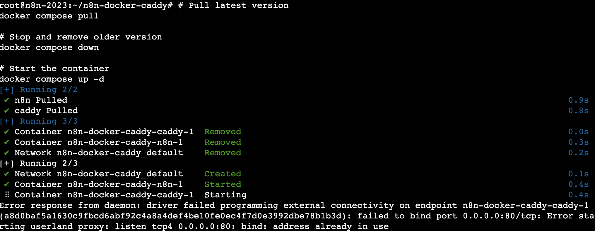

Hi there, I’ve lost access to my n8n instance on Digital Ocean - when in console I use ‘docker compose up -d’ and get the following error,

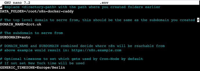

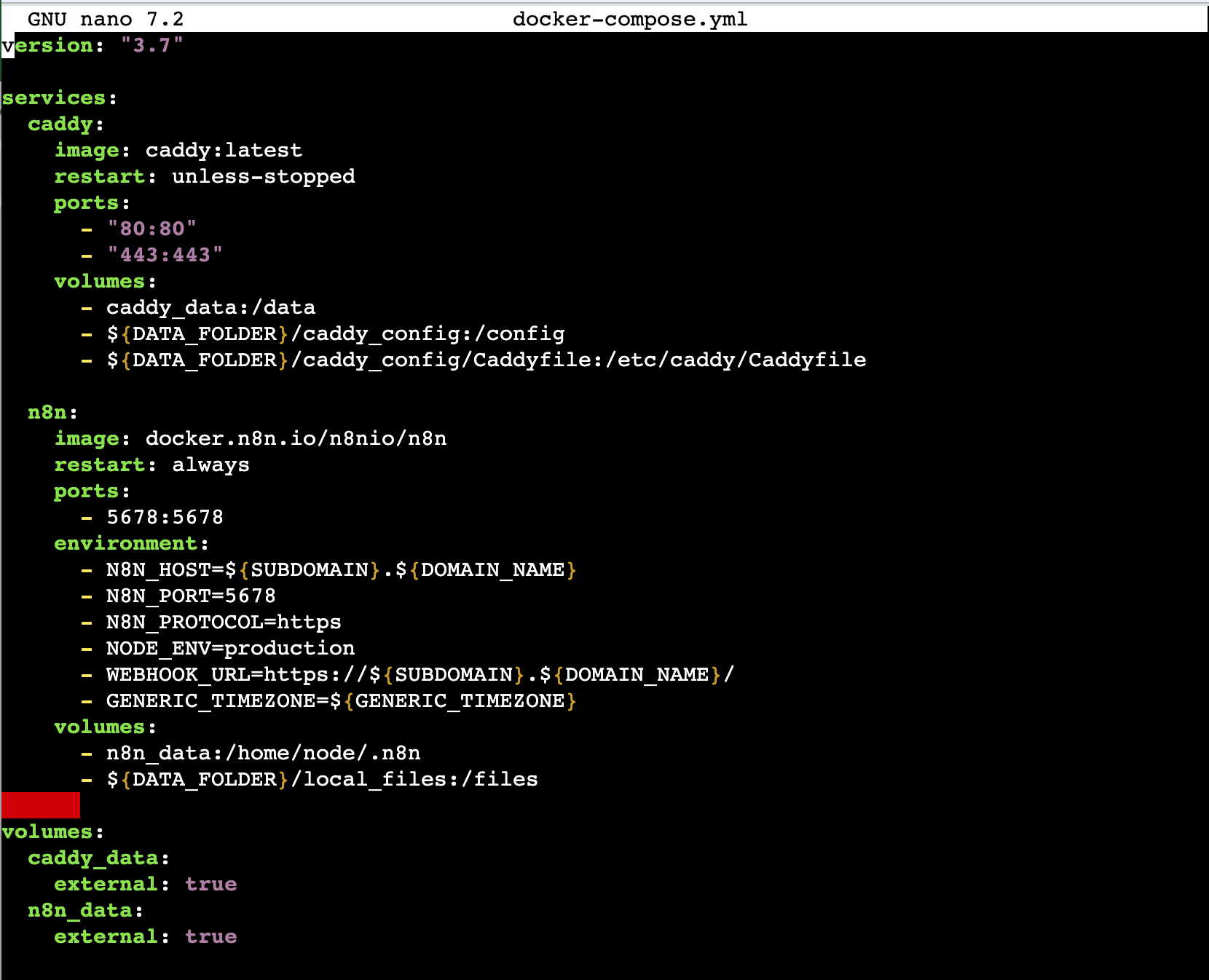

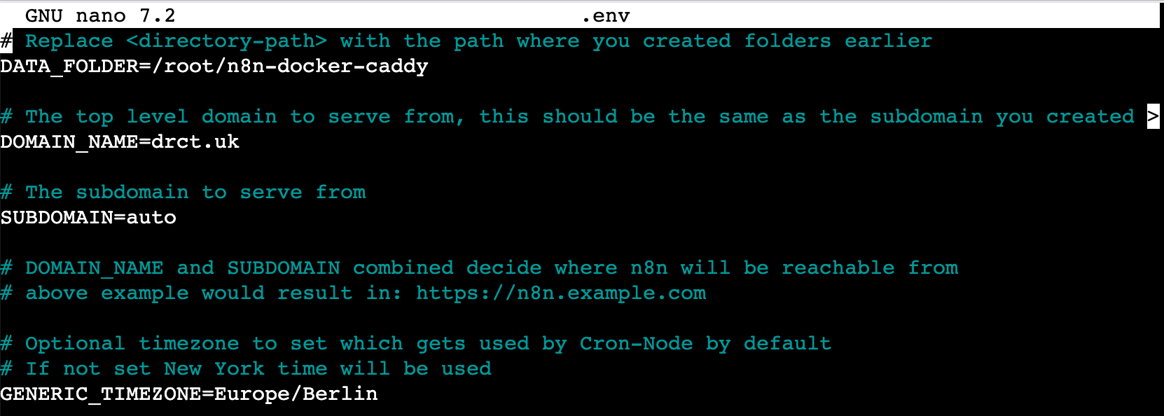

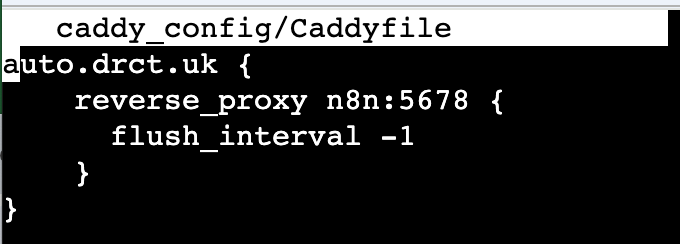

I’ll post pics of my other three files: ,env and docker-compose.yml and caddy_config/Caddyfile
Domain should be auto.drct.uk and DNS all set up

Hey @mackie
The error you are getting is saying you already have an application using port 80.
Can you check what else you have running and if you have Apache or Nginx installed on the server you may went to disable them.
