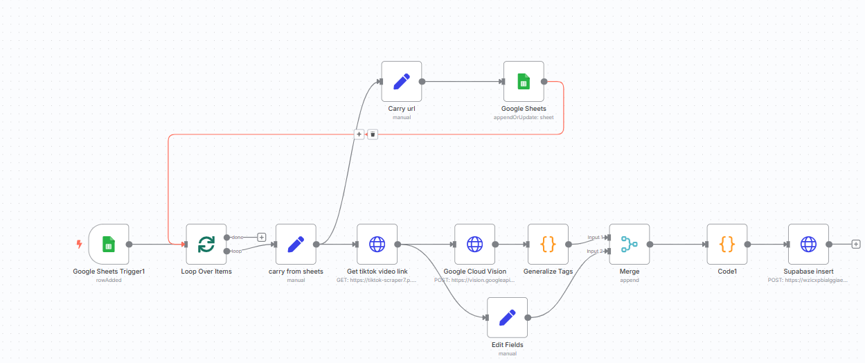

I’m trying to activate my “Official tiktok clipper” workflow, but n8n shows an “Invalid date” error when I toggle it on. The workflow uses a Google Sheets Trigger, RapidAPI to fetch TikTok metadata, Google Cloud Vision for tagging, and Supabase to store the results. It runs fine manually, but won’t activate automatically.

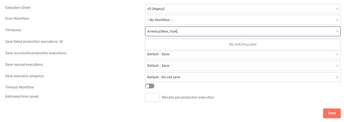

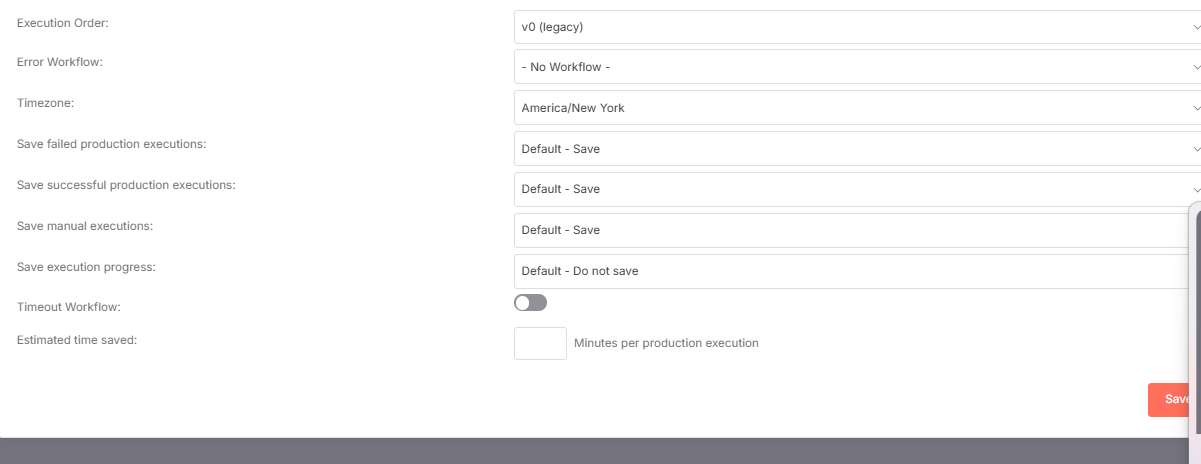

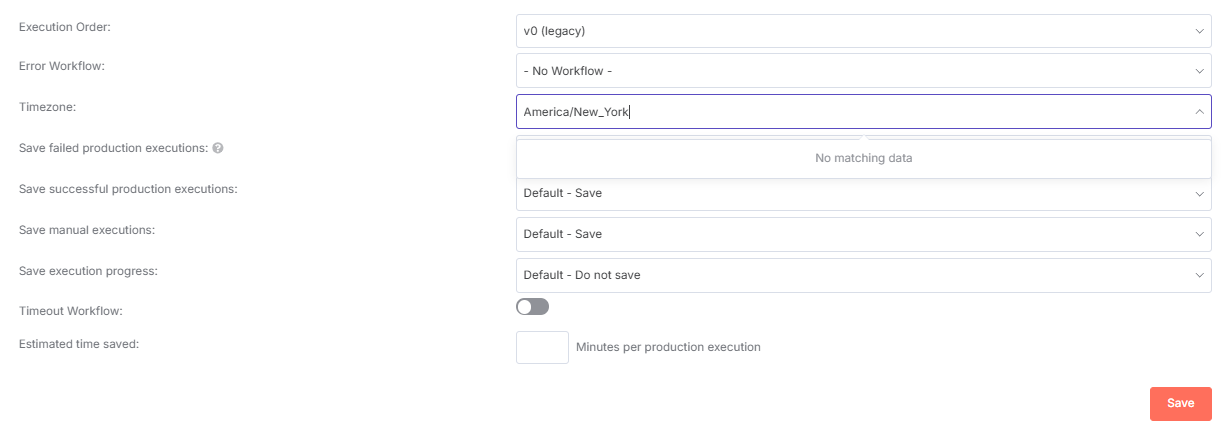

I see you change the initial post, could you please show a screenshot of that setting?
Try changing it to America/New_York (with underscore) and see if that helps
There is no matching data when I put it like that.
Ahh, this is a drop down, I see… Did you specify GENERIC_TIMEZONE in your docker config files anywhere?
