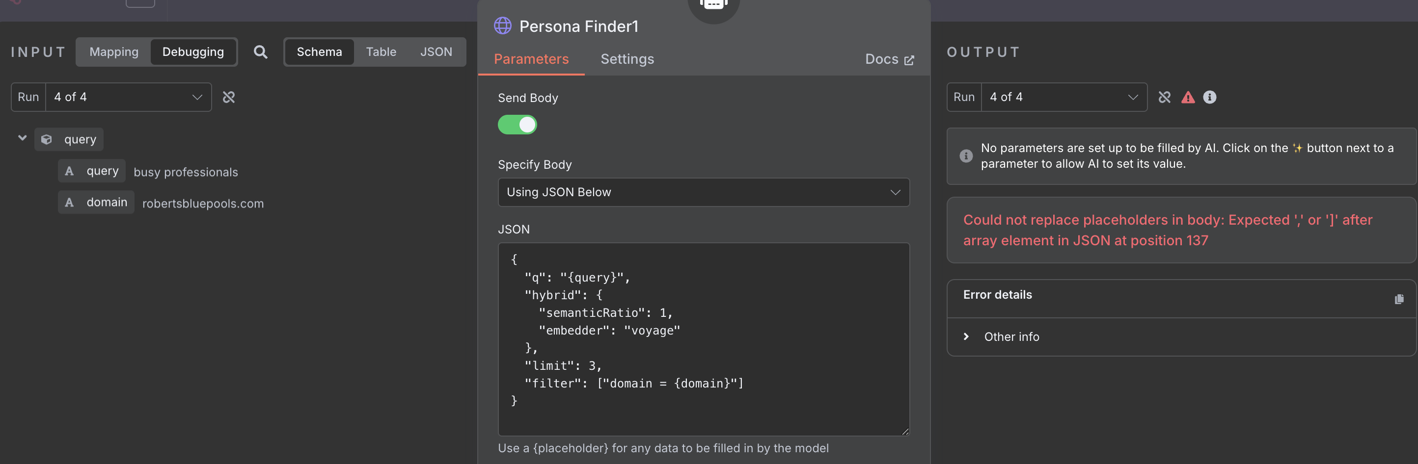

Error when ai completes placeholders with arrays inside http request tool
When ai tries to complete the placeholder inside the body of a http request with an array as a string it fails
Body looks something like this:
args: {
{placeholder}
while the ai tryes to fill it with:
query: {
“[[“field”, “operator”, “value”]]”
When manually replacing the results the json is valid and the request gives the expected result
I believe it is related to the schema not supporting arrays AI tool schema doesn't permit arrays - #5 by Giovanni_Segar
So if @Niklas_Hatje has an update in this issue greatly apreciated
Could not replace placeholders in body: Expected ‘,’ or ‘]’ after array element in JSON at position 287
Hey @Leandro_Espinoza, this is a separate issue, as the schema topic is only relevant for using workflow tools. The HTTP request tool uses a completely different paradigm right now. Do you have an example workflow for us to reproduce this?
I’ve updated the question with the workflow. Srry in advance for spanish.
Hey @Leandro_Espinoza, thanks for the update. I see that in your prompt you sometimes used quotation and somtimes not. Have you tried being consistent there and always use quotation?
I’m having the same issue with no logs or any way to debug why this is failing
Hey @Danilo_Alonso would you mind trying to update to the new version of that tool? You should be able to use our $fromAI there to let AI choose over inputs
