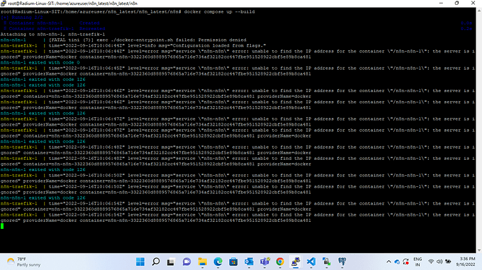

But after creating the custom docker image. I tried to run the docker-compose command to run the docker. There I am getting the errors. I am attaching the screenshot for error details. I have keep docker-compose.yml in n8n root folder along with .env file.
Please guide me as well where I can keep docker-compose.yml file.

Hi @abhilash, this sounds like a permission problem. Are you also facing this issue when using a new docker volume rather than an existing one?
Hi @MutedJam,
Yes I am still facing the same issue even with the new docker volume.
can you please tell which kind of permission and where I need to give the permission.
I am afraid I am not sure what might cause the behaviour here. Let me try building the image once again using the current codebase and see if I can reproduce the problem.
