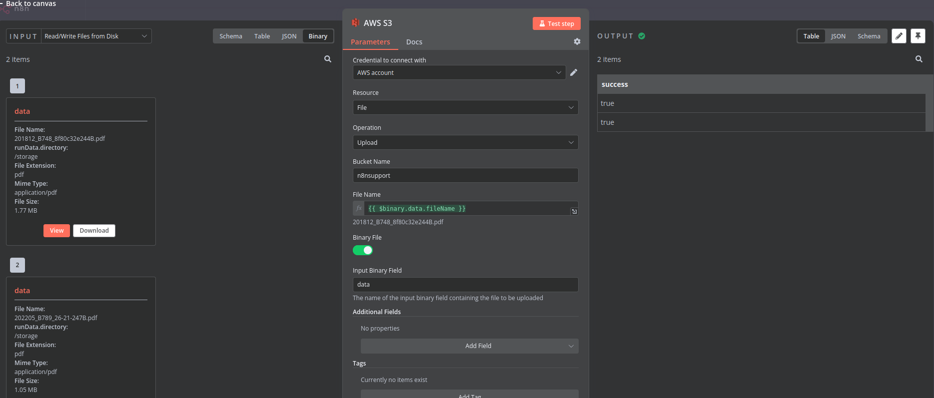

Assuming you simply want to upload the PDF files itself to S3, a workflow like this would do the job:
This will read multiple files from your disk, then upload these to AWS S3:
You would not need to build loops in this case as most n8n nodes (including the S3 node here) will perform their action on every item they receive.
