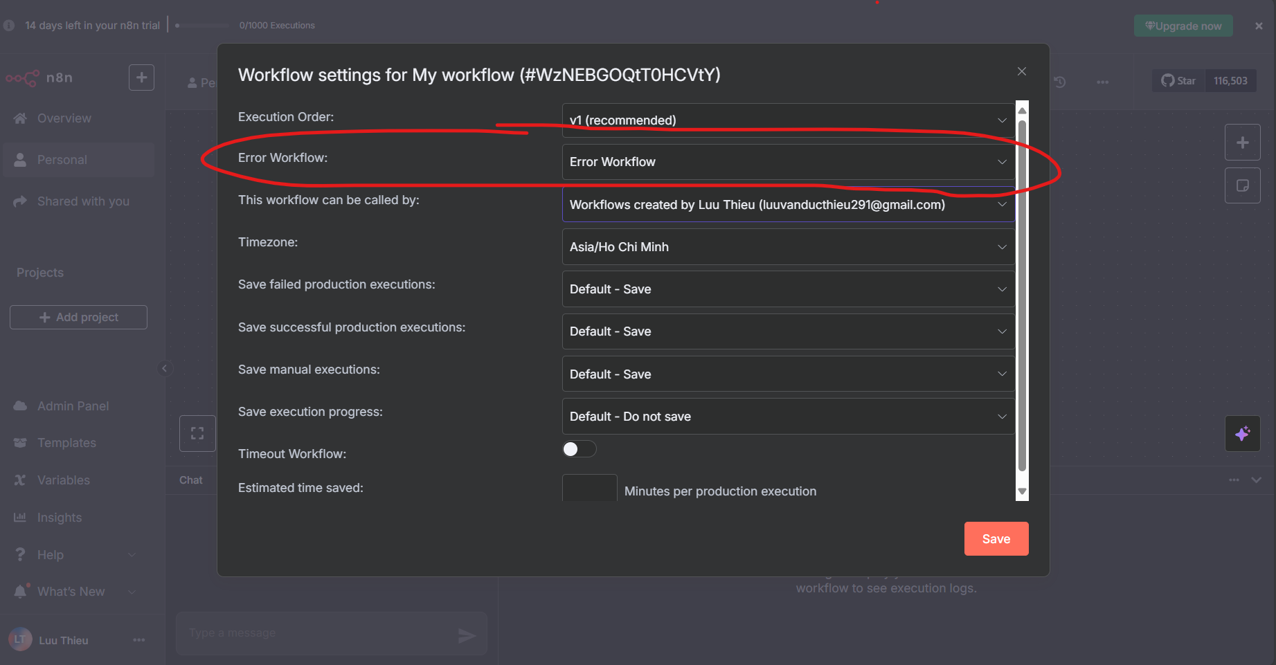

I have config error workflow in the main workflow, but when I intentionally make the error in the main workflow to trigger the error workflow, it is not triggered at all.

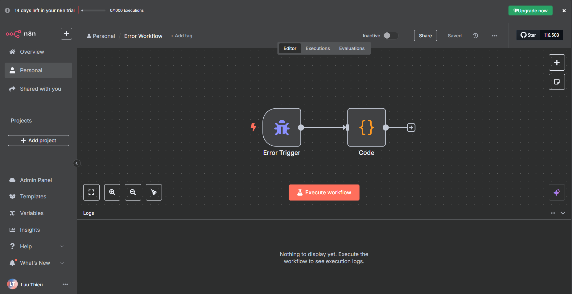

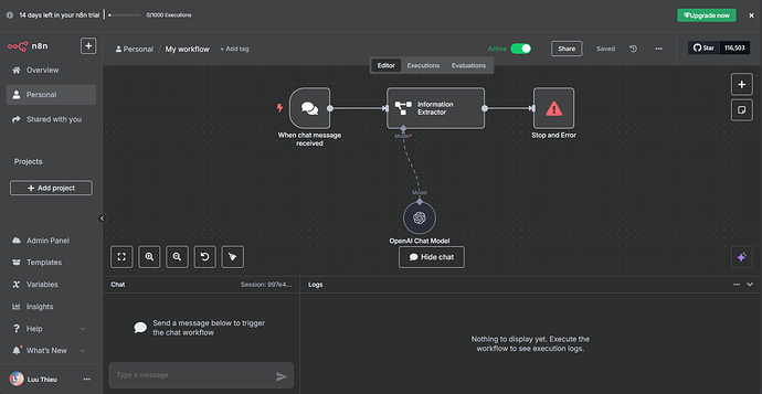

Here is my test workflow and execution logs
Workflows
Execution logs

Error Workflows do only get triggered in production executions, not manual executions (as you did since there’s a funnel icon in your execution logs).
Did you test it via a production execution?
According to documentation, you can’t test the error manually, that includes that you can do Stop and Error node.
If you still wanna try the Error trigger, you can use my nodes to see if the error trigger is triggered
Hope it helps, and kindly mark my message as solution if it solved your problem :slight_smile:
Thank for give me your time, I have try to use Webhook Node and test by Postman and it works :smile:
