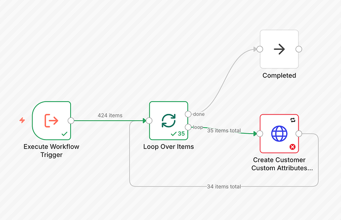

For some reason, my error workflow is not triggered for some workflows when they finish with an error. It is triggered for some othe workflows though so the error handler workflow seems to be working as expected.
See the example below.
No error message; the data_error_handler workfow is simply not triggered.
I don’t thin this is relevant but in the execution above, the last node returned the following error message: The service was not able to process your request

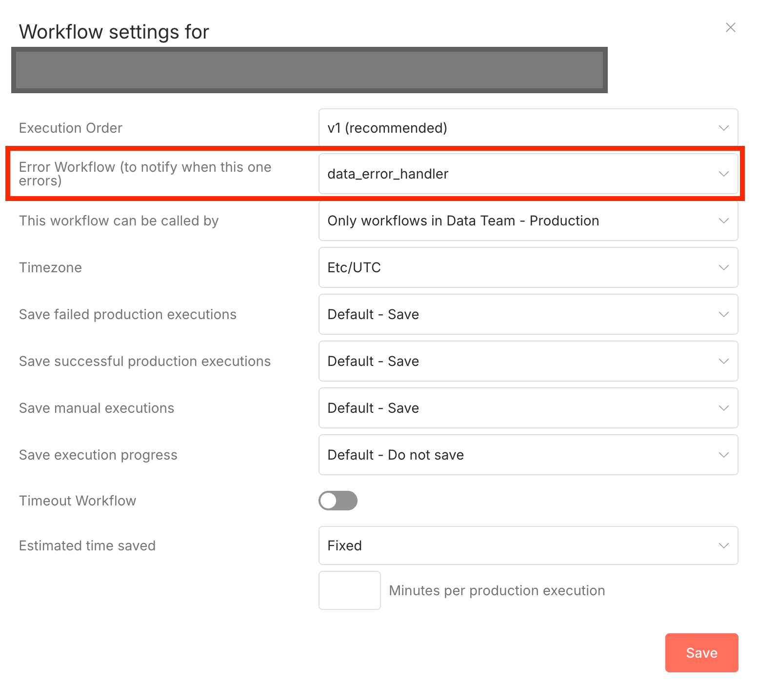

  • n8n EXECUTIONS_PROCESS setting (default: own, main): default with the exception of the timezone and the error workflow as shown in the screenshot above.

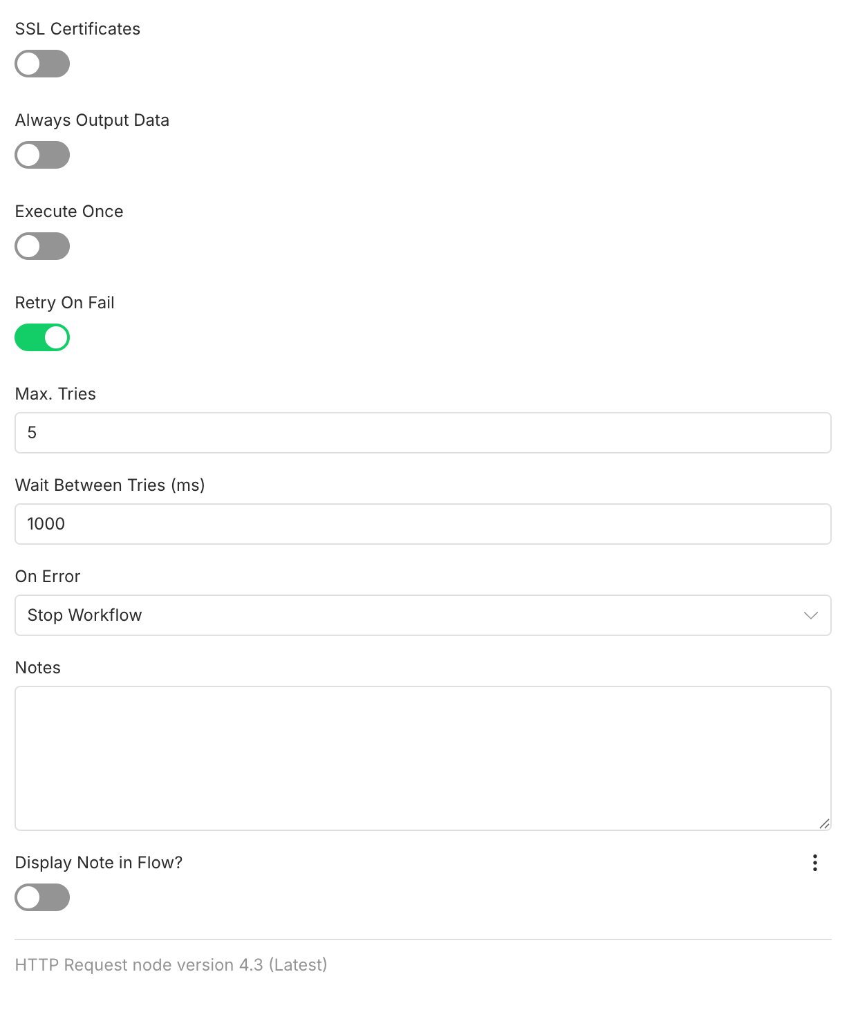

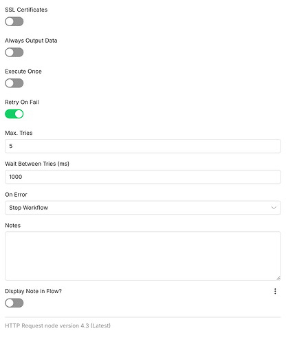

I don’t see a Continue on Fail but I do have the option to Retry on Fail (but it is configured to fail after 5 attempts). See the screenshot below.

Thank you to all of those that chipped in. Turns out the issue was being caused by a malformed JSON which I was using to create the workflows.
I was passing in the name of the workflow in the errorWorkflow setting, but it turns out it expects the ID of the workflow.
The workflow was still being created and in the UI it was still showing the “correct” name for the error handler workflow, which was what caused some confusion in the end.
