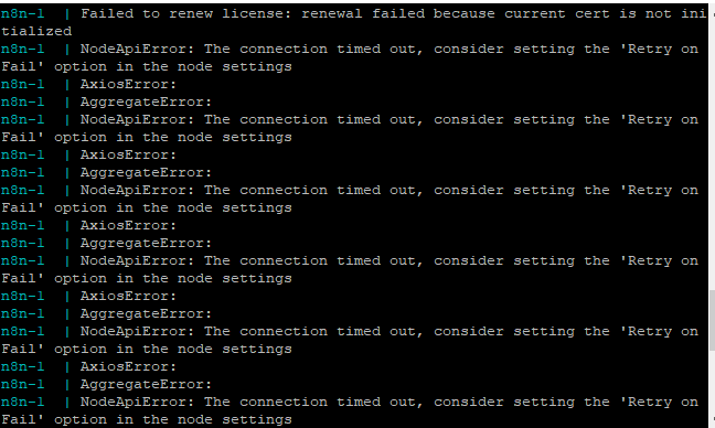

I have the same problem, but with the odoo node. It was working smoothly until this morning and out of nowhere it started to time out.
@tridi We upgraded node.js in 1.47.0, but we don’t know if that fixes the issue.
Can you please upgrade and test again?
If the updated node.js does not fix the issue, I’ll cherry-pick the workaround into a PR and get this fixed in a patch release ASAP :pray:

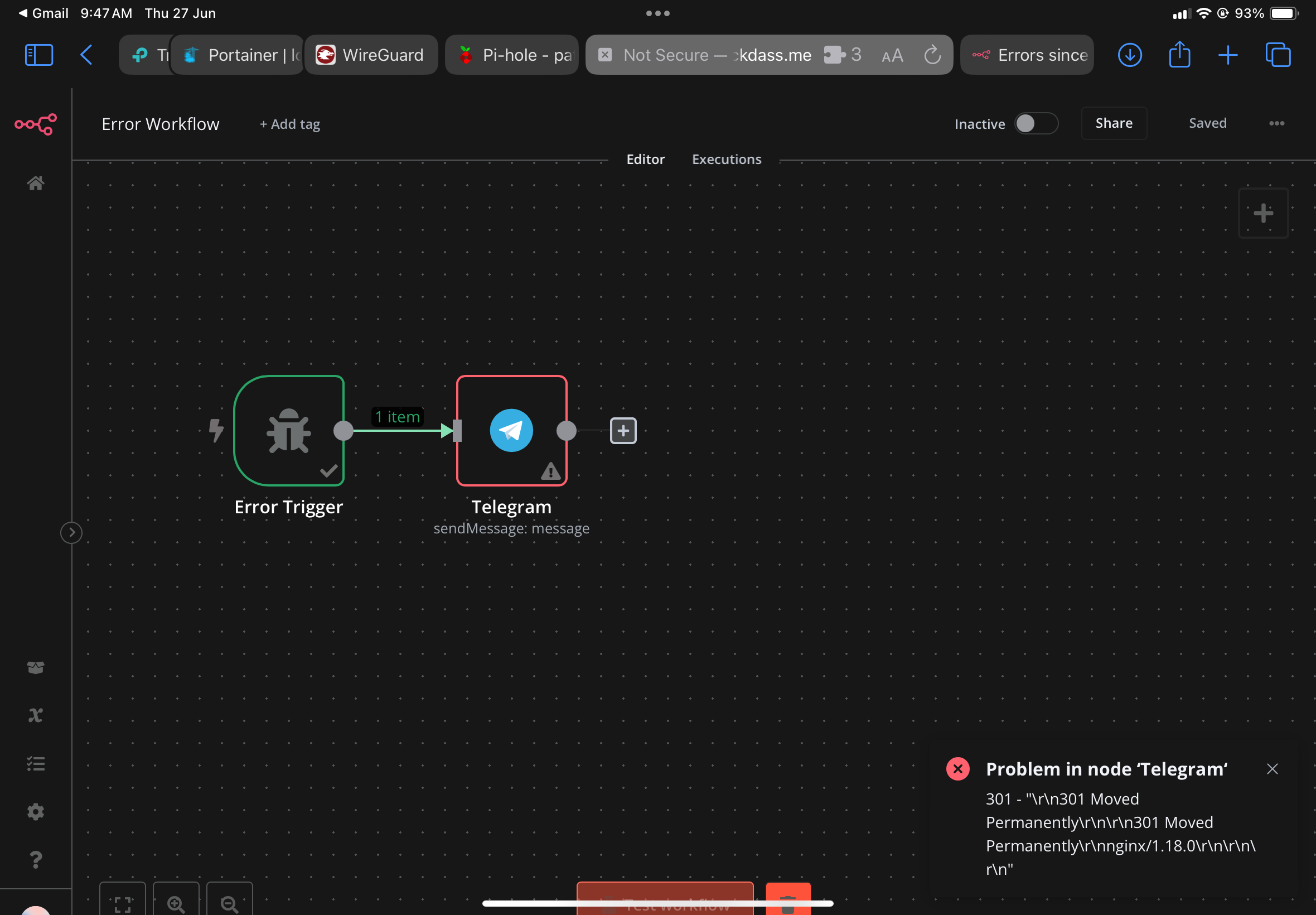

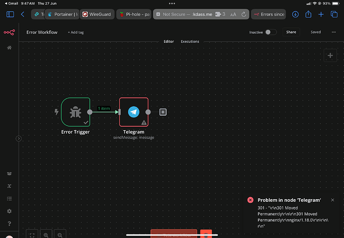

However the telegram node returns this error:
301 - ā€œ\r\n301 Moved Permanently\r\n\r\n
\r\n
nginx/1.18.0\r\n\r\n\r\nā€
301 Moved Permanently 301 Moved Permanently nginx/1.18.0

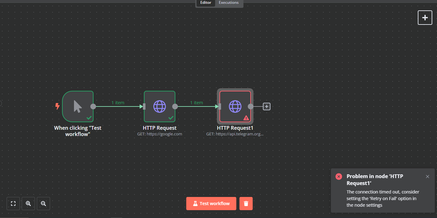

Can you please share a minimal workflow to reproduce this?
It’s also possible that Telegram’s IPv6 addresses are doing something weird at an edge location close to you. You could try adding the following env variable to prefer IPv4 : NODEJS_PREFER_IPV4=true

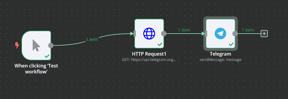

Can you please try running this workflow to see what url telegram is redirecting you to?
This shows me my bots details correctly. Only the telegram node doesn’t work :sweat_smile:
Can you share your actual workflow json and how you have n8n deployed? You are getting a message from an nginx server somewhere which won’t be from us and we have not changed the node so I wonder if maybe you are using a proxy?
Since 1.43.0, Telegram credentials allow settings a custom baseUrl.
Sounds like you have the baseUrl set to some nginx instead of https://api.telegram.org.

I’m running n8n on a docker behind cloudflare. Not using nginx.
You got it right. My url was pointed to http:// instead of https://
Might have left it at that when I was trying to debug why the node wouldn’t work in earlier versions.
Just tested it and it works now.
Once again. Thank you!
