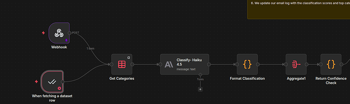

Hi @nembdev !
I’d try inserting a Set/Edit Fields node after the Evaluation Trigger to match the Webhook payload shape, then merge both branches through a No-op node and continue from there. If it still starts at random rows after that, then I’d treat it as a possible bug and share the workflow JSON plus the dataset setup.
The docs say the Evaluation Trigger should process dataset rows one at a time, in sequence, but they also note that if your workflow already has another trigger, you should reshape the inputs and merge the branches before continuing through the main flow. In your screenshot, the Webhook and the Evaluation Trigger both seem to feed directly into the same path, so I’d first suspect the workflow structure rather than the trigger itself.
Hello, @tamy.santos ,
Sorry about that, I didn’t realize both triggers were still connected in the screenshot. It happens without it as well.
I’ve created a slimmed down version of the workflow, with only the eval as a trigger. I’ve attached it here. The dataset is here: test dataset. I removed just about everything but the core process. Same issue, it starts wherever it wants to, then skips around if at all. Appreciate the assistance! Thanks.
