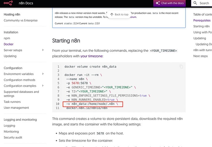

Hi @Matt_Marchio,
You need to set a volume to the n8n data directory so that data is retained across reboots
Here’s an example docker compose file:
services:
  n8n:
    image: n8nio/n8n:latest
    container_name: n8n-main
    volumes:
      - n8n_data:/home/node/.n8n

Also check the official documentation for an example using docker run:
