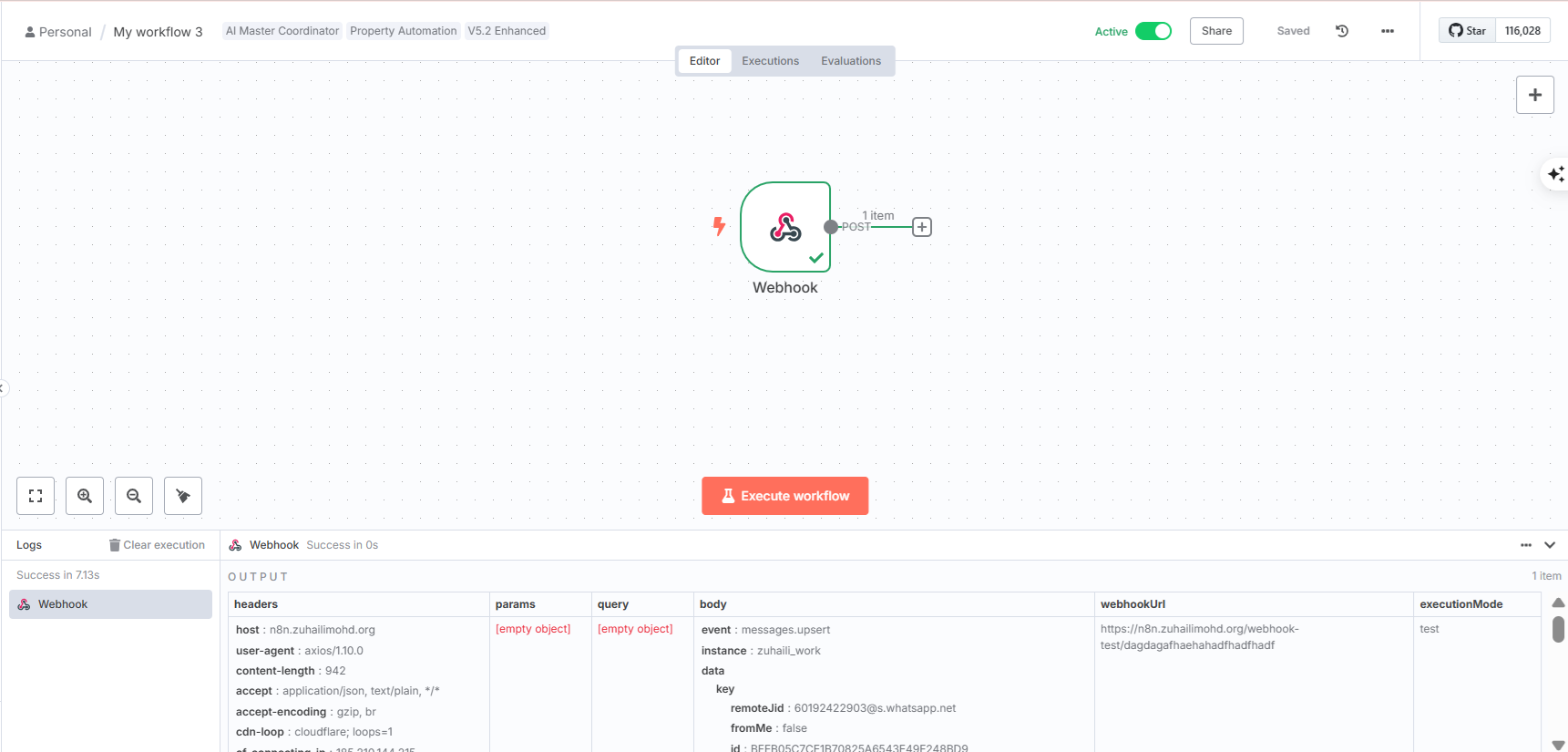

Evolution Api-n8n-coolify- webhook works with test URL but fails to receive data with production URL
Working Scenario (Test Environment):
Not Working Scenario (Production Environment):
  • Using production URL: https://mydomain/webhook/dagdagafhaehahadfhadfhadf
  • When someone sends WhatsApp message to my number
  • Evolution API attempts to send upsert data to production URL
  • n8n webhook is NOT triggered - no WhatsApp message data received :cross_mark:
  • No execution logs show incoming webhook calls in n8n workflow

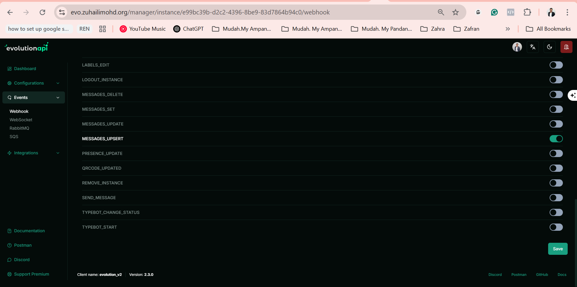

  • Webhook events enabled: messages.upsert

Yes, I already clicked the messages_upsert button. I just discovered that my Telegram trigger in another workflow has the same issue. When I’m using the test URL, n8n can pick up the data and trigger the workflow successfully. But when I activate the workflow and try using the production URL, the Telegram trigger cannot be used to activate my workflow, even though I have already sent the message to trigger the workflow through Telegram.

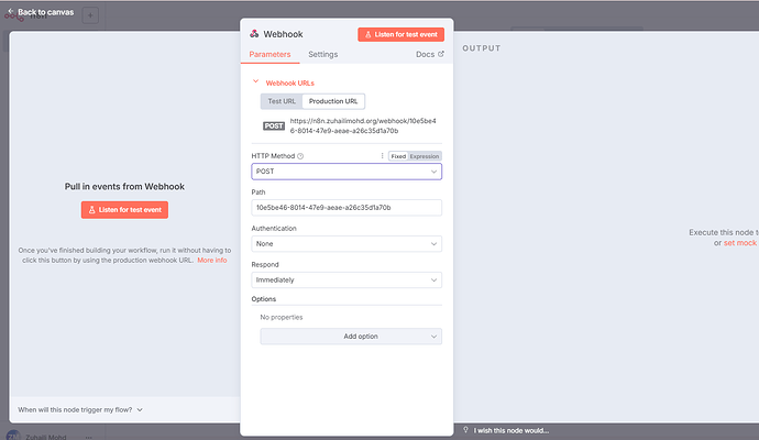

could you also send of a photo of the PArameters of your webhook? myabe the path is the problem

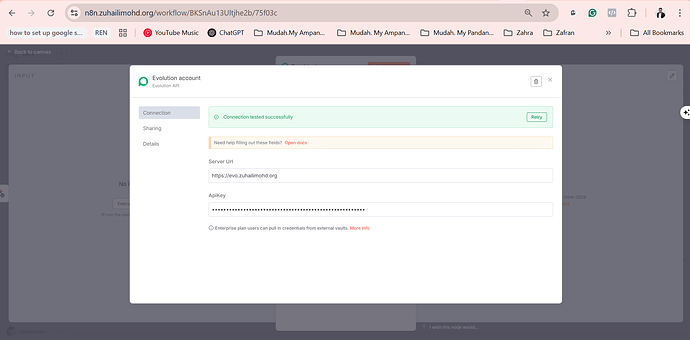

Have you set the webhook URL from the related API Provider?
Yes, I have.
