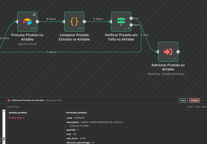

Same issue here!

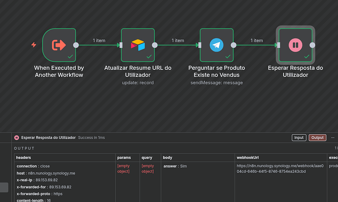

Main workflow:
Sub Workflow:
As you can see the Wait node from Sub-Workflow is returning a different JSON from the one received in the Main-Workflow.
