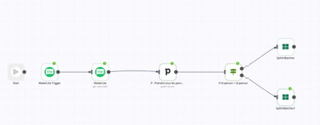

The goal of this workflow is to create a new Person in Pipedrive from Mailerlite only if he is not already in it (not creating him twice)
That may be a really simple task but I’m stuck on it.
I’m gonna explain the process :
Trigger mailerlite : When a Person is created
mailerlite : Get person data
Pipedrive : Get all person data
Set : Stock the pipedrive all person data
SplitIn : Make the data go one by one
If id mail : Compare the email adress of the created person to a email of a person in pipedrive.
If TRUE (email = email ) then do nothing because the person is already there.
If False, I’m stuck here, because I need to know if any is true because if none is true I can make a new Person but If only one is True then I cannot make it.

  1. You don’t need the Split In Batches node. n8n will process all the incoming data. Let’s say Pipedrive returns 10 items, n8n will process all the 10 items one-by-one.
  2. The condition in the first IF node checks if the user is already in your Pipedrive or not. If they are not, you can directly connect the false output to the Pipedrive Node to add new users there. You don’t need another IF node unless there’s any other condition that you want to check.
Let me know if this helps :slight_smile:

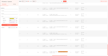

  1. When I try removing the Split In Batches node it actually won’t process the incoming data line by line but rather in groups while taking the first one as its value.
In this example one of the value was TRUE but it did not pass it through TRUE.

The IF process as much data as they are Person in Pipedrive so I will always get False.
Please tell me if this is still a bad explanation ahaha, I’m doing my best !
May I know what comparison you’re making in the second IF node? Unfortunately, the image you’ve shared isn’t very clear and I can’t read it

Excuse me for the picture, I actually don’t have a better quality of it and I modified the workflow.
The first If is for comparing the 2 emails adresses.
I’m still interested in knowing why the IF node does not compare emails adresses line by line.
I am glad you found a solution and thank you for sharing it!
I now understand why you’re the second IF node. In this scenario I would use the Merge node. If you want, I am doing a live session on our Discord server today (in about an hour). I can show you how it can be done with the Merge node there :slight_smile:
