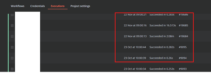

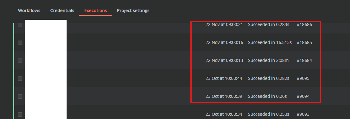

Hi, I just noticed that execution logs tab is missing and when we go to the execution tab within the project logs are gone! It shows only the current time logs. Is anybody facing the same issue?
This is the execution logs within the project.
