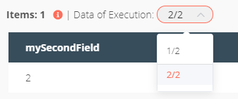

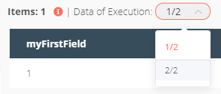

Hi @harshil1712. This is the sample workflow which will endup running the final function node to have more than 1 execution. Basically, I want to extract both executions data on a single group or array or object.
This is how the entire sample would look like and the goal is to get both values
I know that this sounds like a perfect thing for the Merge Node, but on my experience merge node would fail or get stuck in the absence of the other input, and I think this one we’re asking could be a possible solution ![]()
Thank you for providing the information. To make sure that I understood it better, you want to combine the data for different executions. You don’t want to merge the data of different nodes, right?
Yes exactly @harshil1712, well actually, its a bit of both since what makes the Function Node to have 2 different executions is because two different Function Item Nodes were linked to it.
Ah OK, in this case you still want to use a Merge-Node to make sure that both nodes execute before you hit the Function-Node (would not be needed in this case but in more complex cases). Then you can use code like this:
