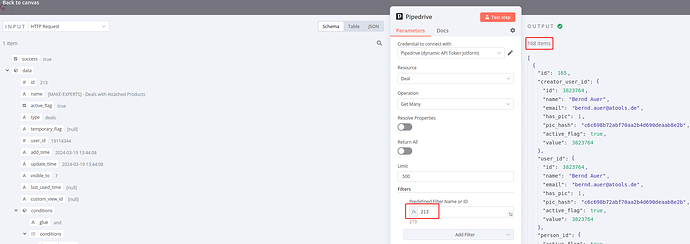

I use the Pipedrive node to get filtered deals but when I use as filter ID the value from previous node the result is 500
if I type in the ID fixed the result is 168
Can you tell me if I’m doing something wrong or is it a bug in the node?

hello @Sebastian1
I suppose there is a type mismatch. Can you check with the below option?
{{ String($json.data.id) }}

Hi @Sebastian1, that is indeed very mysterious. Would you mind pinning your data, downloading your workflow and sending it to me via DM? Have you tried updating to the newest version already?
fyi: I was messing around with this a month ago or something like that and I got it to work.
In the end we didn’t use it like this so I deleted it and cannot copy it sadly.
But what was the solution. delete the node and create it again?
I did sent it to you. I didn’t try the newest version since I first wanted to check if this is a known bug in this version and fixed in newer ones
This is strange. I did have to add a node in between and then added the value as this {{ $(‘HTTP Request’).item.json.data.id }}
with that it worked…
There might be a bug but not sure since I’m new to n8n and at the moment I don’t know If I’m doing wrong or the system…
I will have a look at your workflow, thanks a lot for sending it. We did rework the expressions quite a lot in version 1.33, so it might be worth upgrading to this one to see if it works there.
For everyone reading the thread: The expressions work as intended. What happened here is that Sebastian connected multiple nodes with the Pipedrive node that holds the expression:
