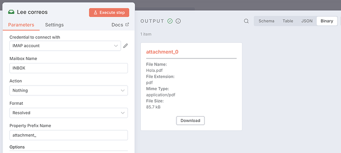

I’ve email trigger, and upon receiving a valid email with an attachment, I then validate that the attachment is a PDF and has a specific identifier. If it does, I want to pass this PDF to an AI node to extract information. In every case I’ve tried, when passing it, it tells me there’s no file to process. Could someone help me understand how I should pass it so the node can process it?
I’ve tried a read/write with a code node, but without the expected results.

If I do this I have this error “The item has no binary field ‘attachment0’ [item 0]
Check that the parameter where you specified the input binary field name is correct, and that it matches a field in the binary input”
If I use a Execute node to download the file to my disk it work ok, so I can’t understand why if I pass it to other node it doesn’t work.

That’s because the default binary file name is set to data in the Extract Data Node
You just have to replace the “data” with the name “attachement_0”
Thanks @Sulieman.said I changed the name and it work!
