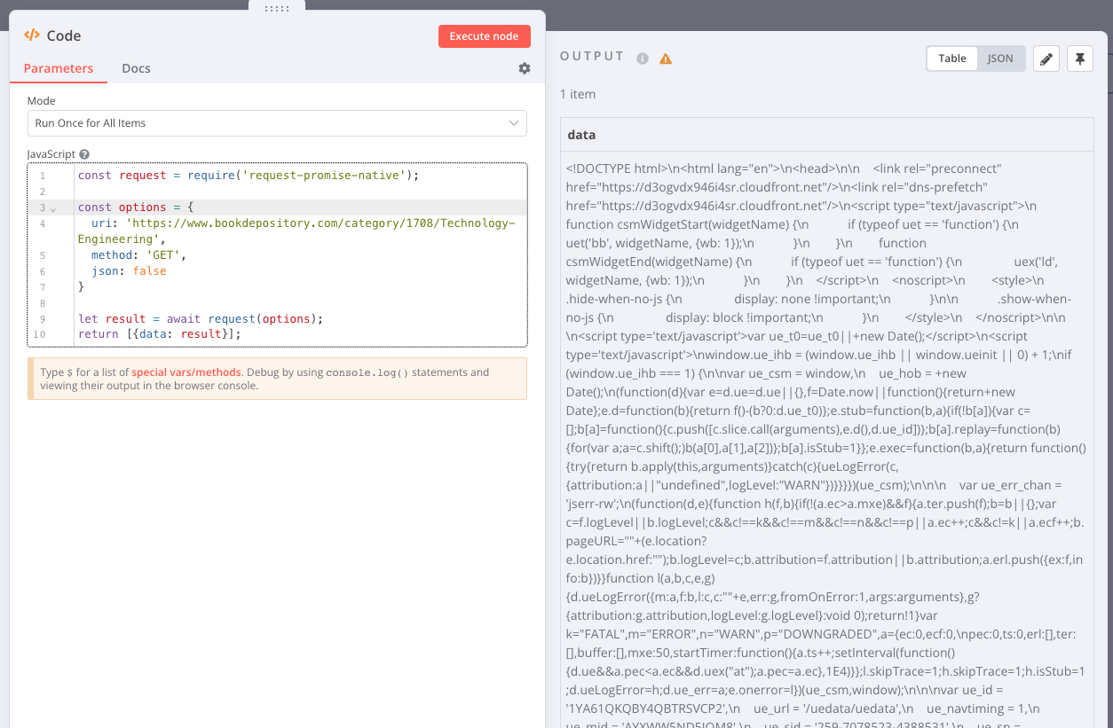

Hey @duler_rok,
Perfect, So in the Code node if you want to reproduce all of that up to the Item Lists node you would need to reproduce the behaviour of the HTTP Request node and HTML Extract nodes so the first thing to do would be to find an HTTP request package you are happy with using then importing it into the code node and using it like normal from there. Then it would just be a case of working through the HTML string that is returned.
So you could use something like…
const request = require('request-promise-native');
const options = {
  uri: 'https://www.bookdepository.com/category/1708/Technology-Engineering',
  method: 'GET',
  json: false
let result = await request(options);
return [{data: result}];
Which will give you this back…
Then it will be down to having fun parsing that.
