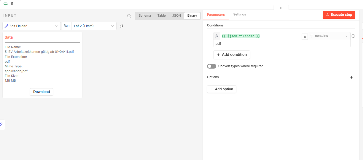

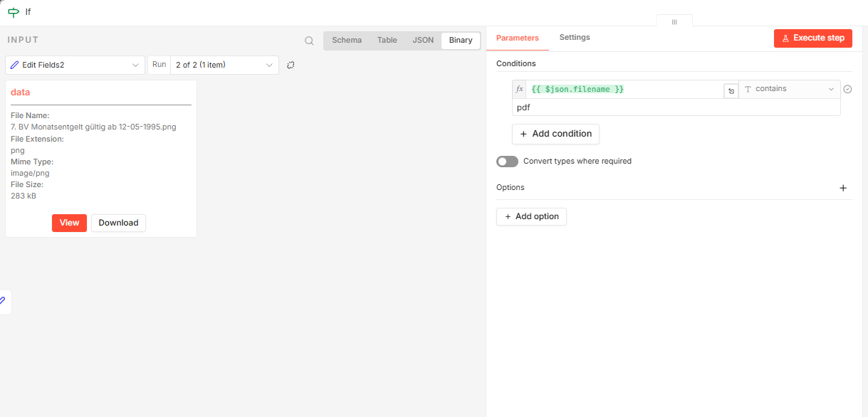

I’ve already implemented it this way, but I’m still running into the same issue as before.
It seems like the node is not evaluating the current item/file, but instead checking whether any of the previously uploaded filenames contain “pdf”. Because of that, it incorrectly treats all subsequent files as PDFs, even when they are not.
So instead of checking the current file’s type, it looks like it’s referencing past values from earlier items in the execution.
As you can see, there is one PDF and one PNG file, but the second file (PNG) is also being detected as a PDF.
This is incorrect, since only the first file is actually a PDF — the second one should be routed through the image/PNG branch, but it is still treated as a PDF instead.

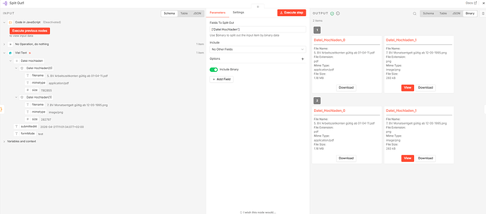

When I try using the Split Out node, I run into a similar issue.
The output still keeps both files bundled together, and instead of properly separating them, it just duplicates the same combined result twice.
At this point it feels like the workflow simply isn’t handling the individual files correctly anymore, no matter which splitting or routing approach I try.
