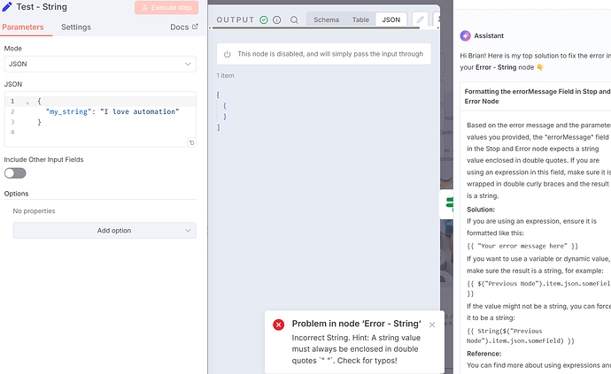

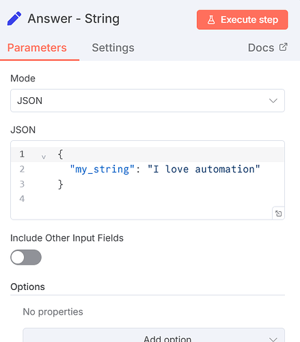

Describe the problem/error/question I am attempting to do the JSON knowledge test. my answer to the first flow step is exactly the same as the answer key but i get an error. Then I literally copy pasted the answer key into my flow step and still get an error. My flow step:
flow step in the Answer Key
What is the error message (if any)? Problem in node ‘Error - String‘
Incorrect String. Hint: A string value must always be enclosed in double quotes " ". Check for typos!

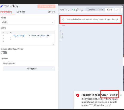

Hello @BAdamBafiesta,
I think the error is in another node (Error - String), not the one in the screenshot, and the one in the screenshot is disabled..
thank you. looks like i need to “active” the nodes. the error was not in the syntax as you helped identify.

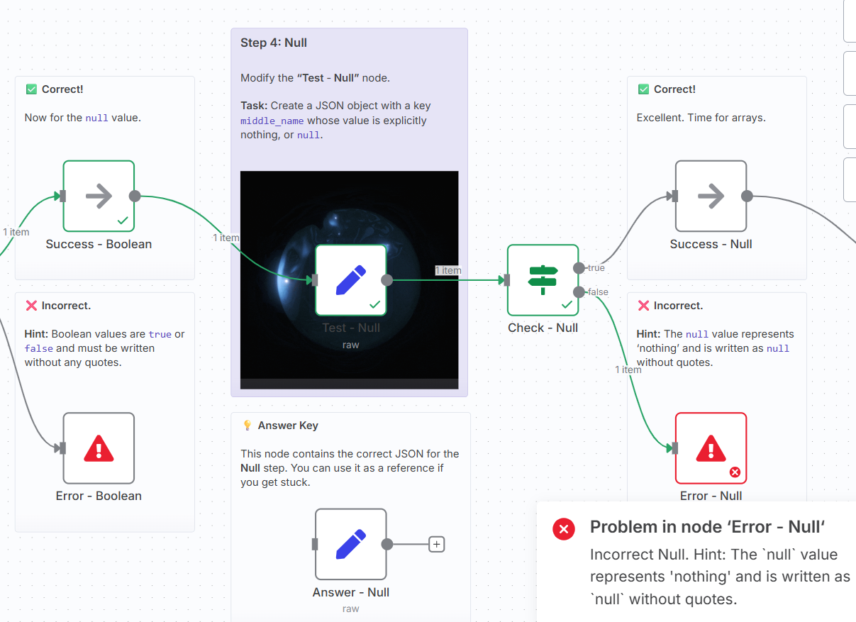

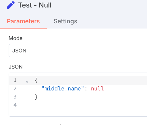

Now I am stuck a few nodes later. Once again my answer looks exactly like the answer key. I again copied the answer key into my answer and still get the error
Problem in node ‘Error - Null‘
Incorrect Null. Hint: The `null` value represents ‘nothing’ and is written as `null` without quotes.
despite non quotes in my answer.

My mind was about to explode because of this issue since I was just experimenting and i got the same error,
You’re probably using this workflow:
So, after several attempts, I discovered that there was something wrong with the if node in that specific workflow,
Anyway, the solution is to delete the if node, create a new if node, and set the same conditions.
Then it should work correctly.
